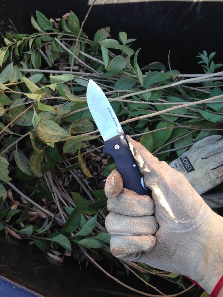

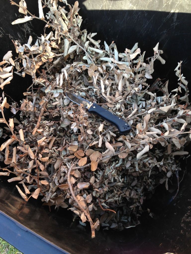

I used the knife for some small tasks around the house. Cutting dead branches, cutting greener branches with a slight chopping motion holding the blade lower on the handle for snap cuts. The knife proved to have no issue operating it with gloves.
Then cut up some old dirty cardboard.

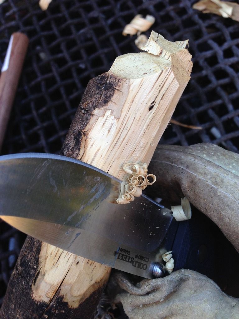

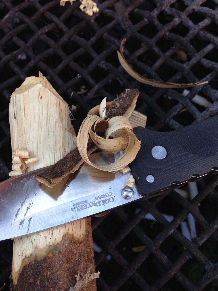

Whittled some wood. Harder cuts shown first, and finer cuts shown second. Both were alright, but dropping the edge angle would dramatically increase performance in this aspect.

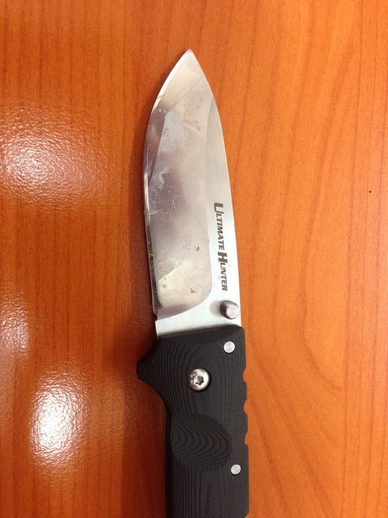

How the knife looked after the work.
Final sharpness test. Slightly duller.

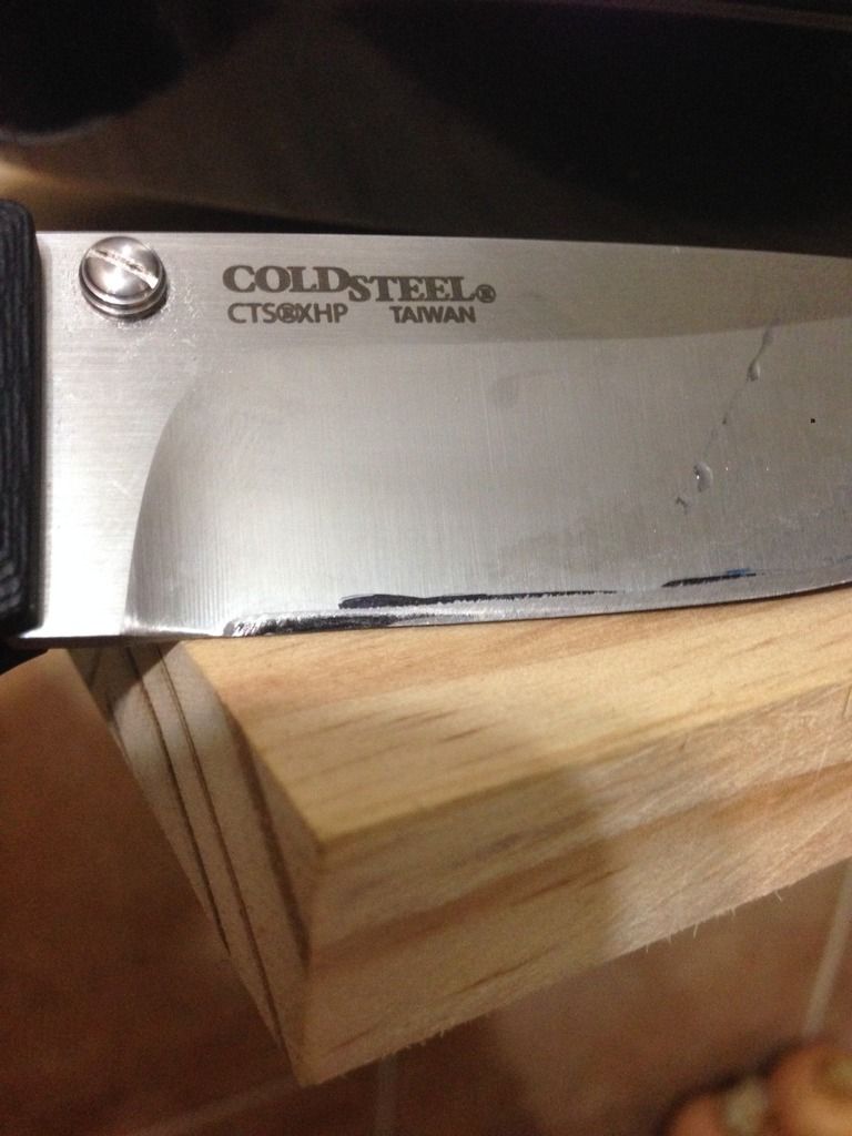

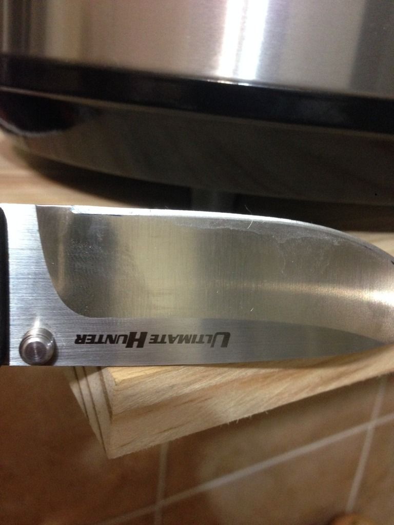

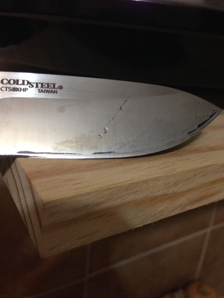

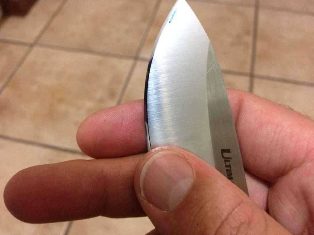

Bevel was around 20 degrees on the one side (presentation side) and 12 degrees on the other side (back side). So sharpening on a Sharpmaker one could easily see the 15 dps would micro bevel the one side and hit the shoulders on the other side.
Back side with micro bevel.
I swapped the stones to the 20 degree slots and one would start to hit the entire edge on the presentation side.
After this I decided to reshape the edge.
The low angle side (back side) was easy of coarse as my freehand sharpening tend to be around 10-12 degrees. The only place I needed to spend more time on was towards the base of the edge.
20 degree per side (presentation side) took a bit longer but the bevel was more consistent towards the base of the edge.
I ran 320 - 600 (diamond stones) and the UF ceramic stone. Results were a nicely polished edge.

I did modify the blade now to minimize the unsharpened part. Forgive the dirty blade, took it out of the sampling bag and took the photo. I am not too bothered about the thickening of the edge towards the heel as I will most likely regrind the blade some time in the future. Will sort it out then.

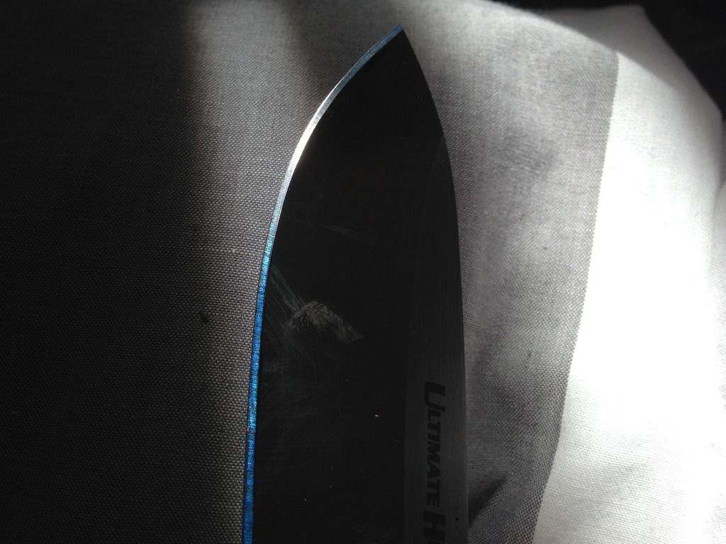

Chiral, when I saw those pics, I was thinking in my head, "Now THAT is how you grind a hunting knife!", and then noticed your comment at the bottom. Like the EXACT words I was thinking! I grind my hunting knives like picture above (with a hand rubbed finish lengthwise tho). Looks to be slightly convex toward the edge.....looks great and I know how a knife ground well like that is a real pleasure to use over the stock grind.
Thanks for the thread, Marthinus, and thanks for the post/pics Chiral. Very cool. That's how it's done, folks.

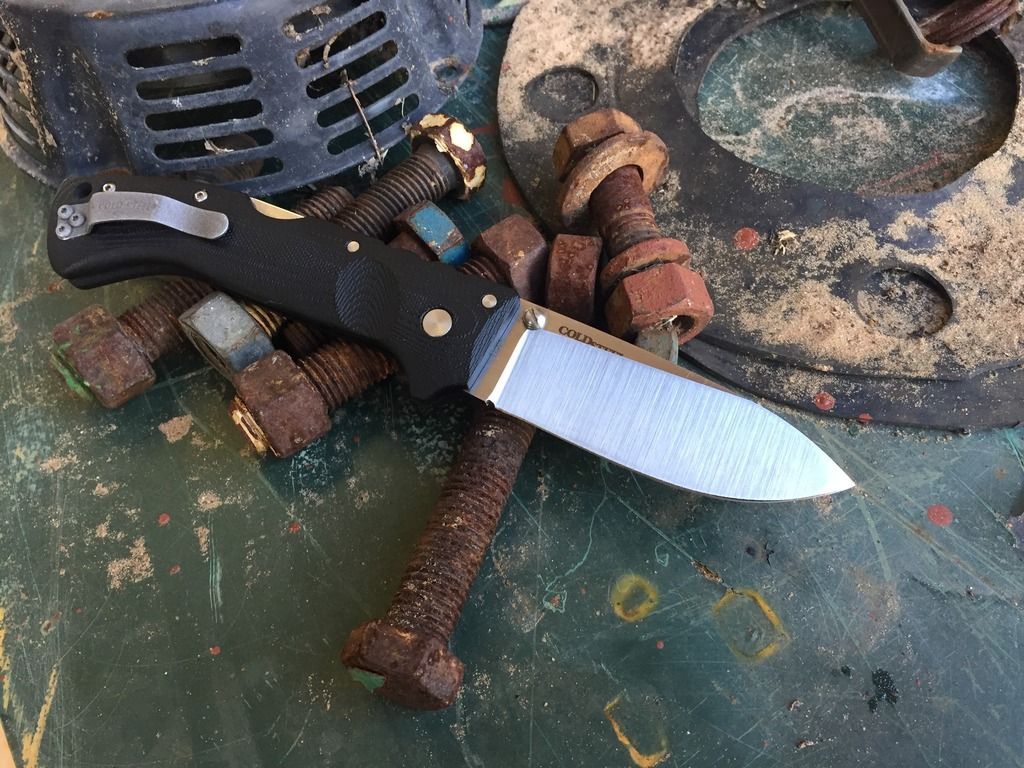

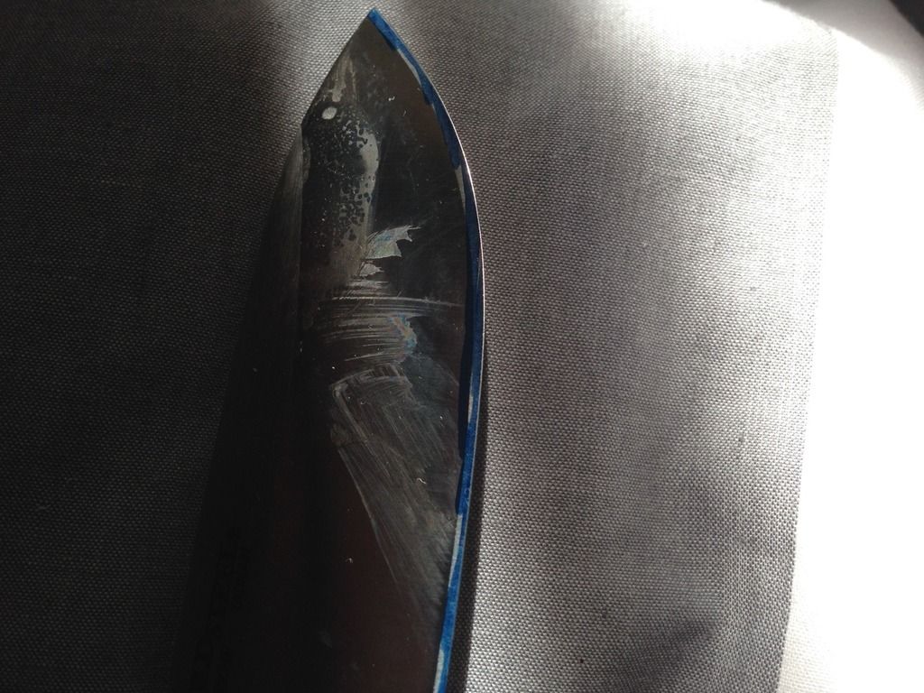

I have used the Ultimate hunter on and off for some time now, light processing of some poultry and some meats. I did not like the thick grind. Rather than copy what REK I decided to do a hollow grind.
Average thickness behind the edge is 0.25mm with 0.5mm (0.0020 inch) about a centimeter up from the edge. I did a full mirror to see how it feels on the belts, then went back to 60 grit with a light 800 grit over the 60 grit to smooth it out a bit.
CTS-XHP is still far more similar to RWL-34 than I anticipated, polishes, grinds the same way on the belts. RWL-34 for me is the bees knees of balance between properties so this has been a pleasant surprise.
The lock has settled in deeper than when I received it.
