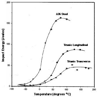

I don't even know why this is a debate. Practically all materials become more brittle in lower temperatures. How much and whether it is a concern at all depends on a plethora of other factors, such as steel type, heat treat, geometry, the user, and the intended use...
For metals like steel, there is a transition from ductile to brittle within a relatively short temperature variation. It is not a linear curve.
If you feel up for some research, you could probably find academic papers in regards to the ductile-brittle transition temperature for various steels. They would probably be for annealed steels though.
The problem with this graph is there are no numbers. The temperatures and impact energies that apply to a human using a knife are not in the realm of concern.
The graph was just a visual to aid in understanding the ductile-brittle transition temperature.
And I can assure you that some steels do become brittle in temperatures encountered in the great outdoors... especially older steels. In modern steels the temperatures are likely very low, like -50C or lower still. But again, this is for annealed steel.
For the vast majority of users it isn't a concern. But people do live in areas that experience bitter conditions, so there is portion of the population that might want to research it further before settling on a knife. Imagine you're in the arctic and you need to sharpen your knife with a diamond rod. I could easily see someone chipping their knife under those circumstances.
Anyway, here's another chart with numbers. A36 steel of course isn't used for making blades, save for maybe some homemade stuff, but it does illustrate that the transition temperature can be high enough for steel to be of (SOME) concern for certain demographics. It's plainly obvious that there is a dramatic decrease in ductility.
