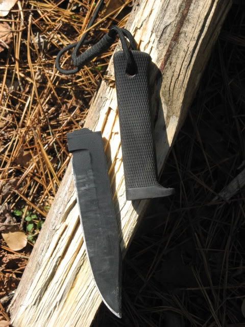

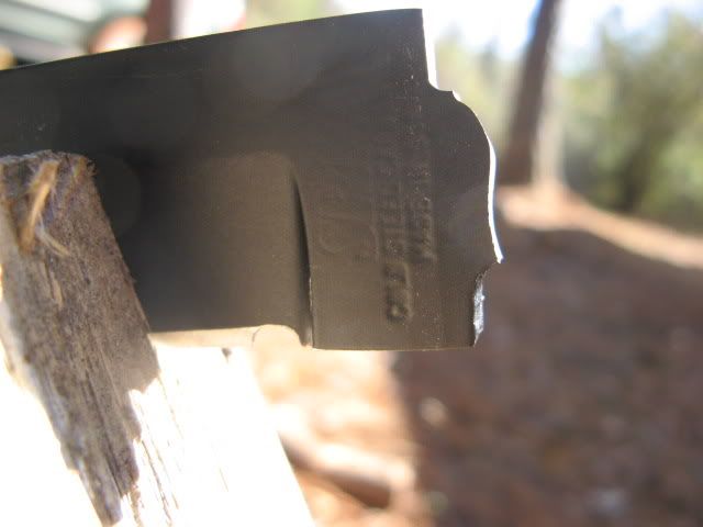

Well, I've never had a SOG, so it'd be more accurate to say I'd recommend against the Cold Steel. I've had an SRK for years and never really used it too hard. Last weekend I decided to try some very light batonning with it. It had never been batonned before, in fact never struck with anything, just general cutting and digging in wood. I always thought of it as a fairly tough knife, but this happened at just the third strike with a small length of wood. I left the blade in the wood where it broke, and you can see how far it made it through this very clean wood (no knots, etc.). And I wasn't hitting it very hard, either.
Wow! Ive actually been meaning to get an aus8 SRK, but those pictures are making me reconsider! I always thought the SRK was one of the toughest blades for the money.
I'd send that knife back for a free replacement!!

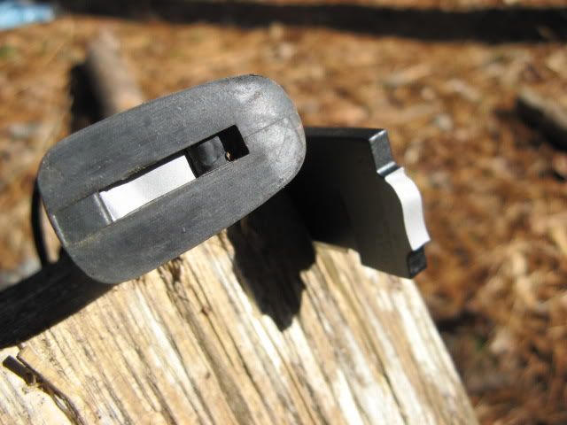

I guess it had a weak tang.
Another reason to look for a full-tang for batoning wood.(or a good Hatchet)
Send that back. They'll give you a new one. No way that should have happened. :eek:
I've used my SRK for years, including tons of batoning. It's been real rugged.
I doubt I'll send it back. It's Carbon V I actually bought it probably 15 or so years ago as a factory second. These are supposed to be sold as seconds only because of cosmetic flaws, so I don't think that had anything to do with it. It was at a great price, and has since dug so mant bullets out of trees and logs that I don't feel I'm really out anything. :D
In looking at the broken blade up close, it doesn't seem to have snapped at a particularly poorly-designed stress point, but it's hard to tell with the tang still in the handle. I may cut it out one day for a closer look.
Also, I'm not here to bash Cold Steel. Those that have them may never run into this, but I don't think I'll order another one for any hard use. They do make a pretty good light camp knife for many tasks.
