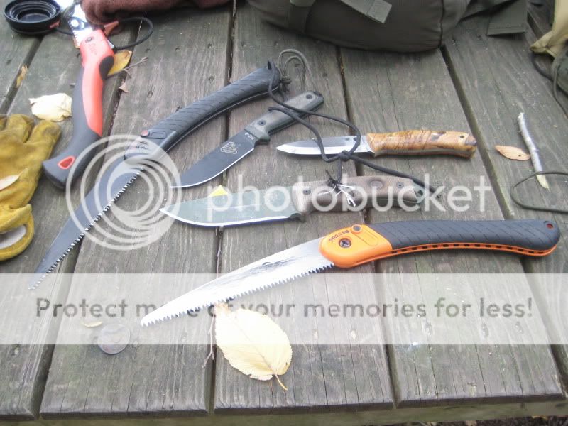

For day hiking I prefer a folding saw such as the Kershaw or Bahco pictured below.
If you're planning on processing huge logs a larger buck saw is definitely the way to go.

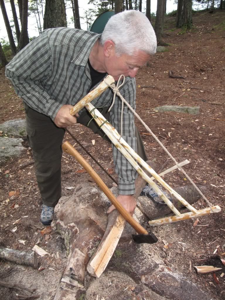

If you don't go for something like one of the big Silky saws, I too would recommend making up your own bucksaw rather than buying one of the commercial things. :)
I am sure there are threads on here about doing so, there are also some on this UK site.
http://www.bushcraftuk.com/forum/showthread.php?t=18672
http://www.bushcraftuk.com/forum/showthread.php?t=42706
The problems that I have seen with the triangular commercial saws is that they really restrict you in the size of wood you can handle, the frame can foul on the work very easily when trying to take full length strokes. Some of the folding bow-saws also use kind of weird blade lengths which can be hard to find. Maybe this is less of a problem in the US, but a lot of the hardware and gardening stores in the UK don't stock anything less than 18".
I was dubious about carrying a long blade in my pack, but once wrapped in webbing and coiled up it wasn't really any trouble, just had it at the top of the pack under the flap. A 24" blade works great and can still be used very efficently for smaller wood by pinning the frame to the ground with one foot, bracing the other frame end against the body and moving the wood against the blade with both hands.
The pictured saws use no nails and are just held together with pressure, but a more permanent frame would be easy to make up.
