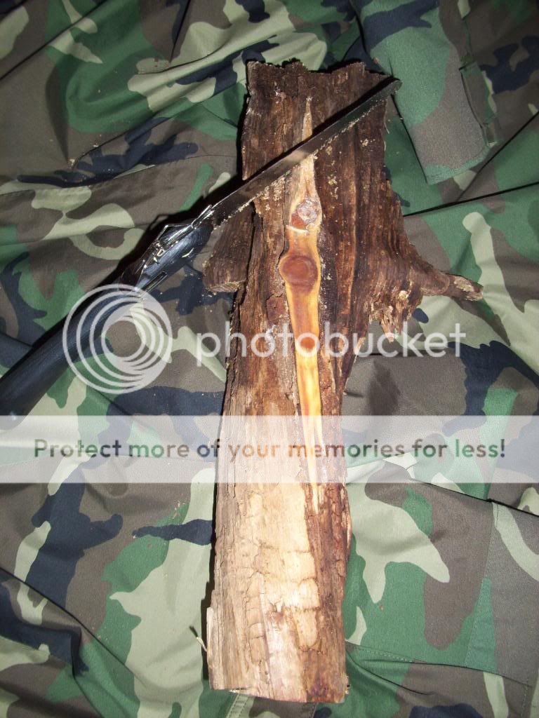

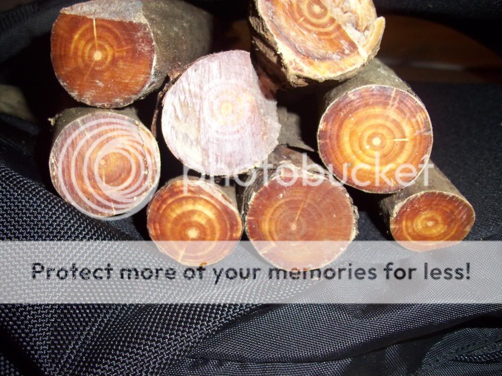

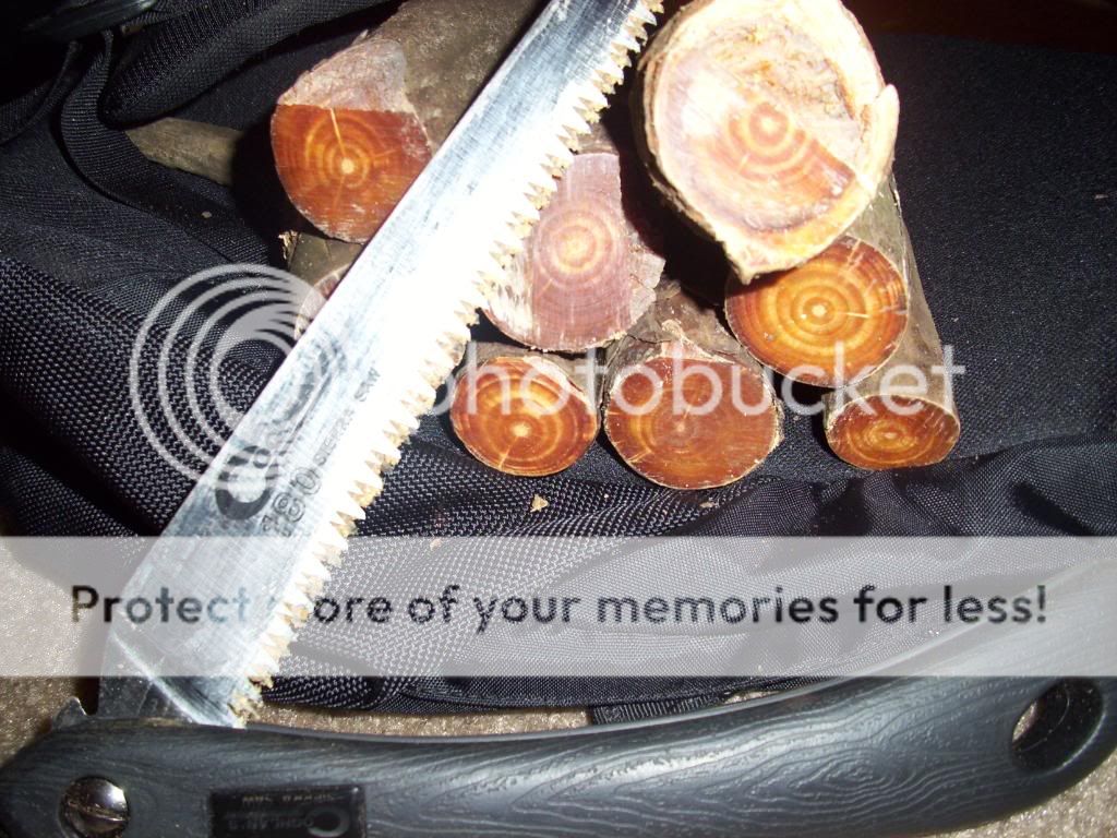

I found and got my own, I just went back out to check the trunk... I found the branches at the bottom of the trunk were full of resin.
I figure these branches will be easier to split as well.

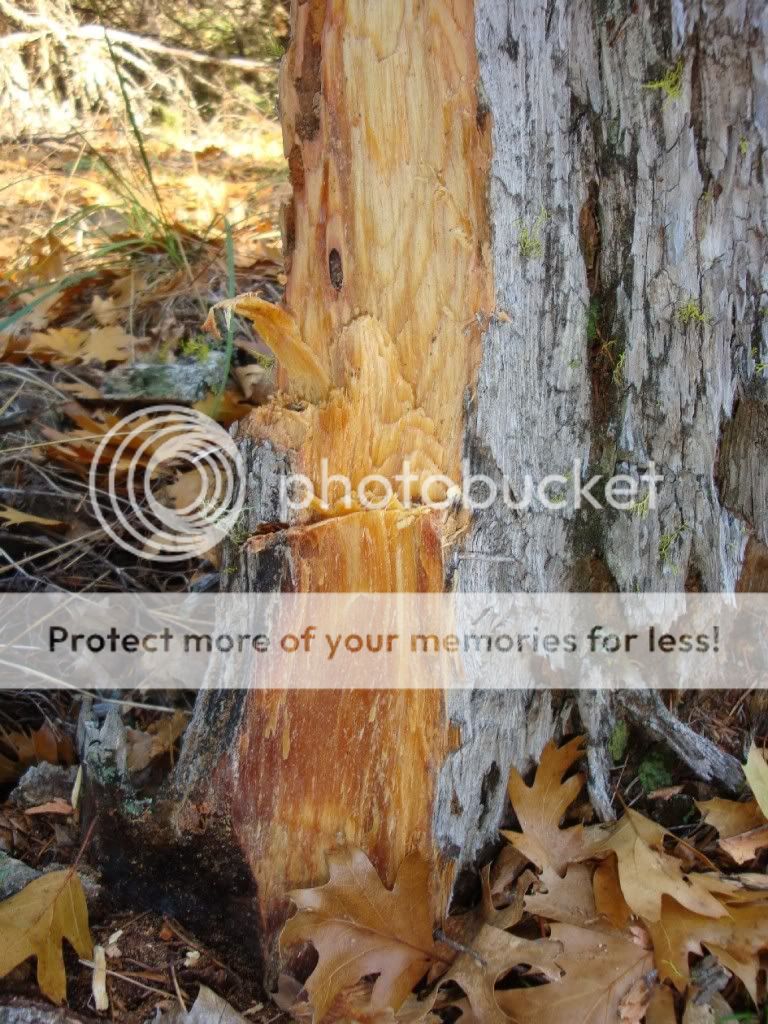

thats some high quality stuff skimo! I went out yesterday and found a stump about 10" around that was solid fatwood like those branches..I didnt leave any behind LOL..Good score man!
Thanks, I let one of my military buddies in on the stash, he'll be taking his axe and an A3 bag to haul some out.
Great score on a 10" stump that's chock full of resin!
Branches are so nice because they split so easily, no knots. :D
I should be able to make some sweet beer coasters from this one.
Come's in right at 6 pounds, 2.72 kilos, 0.43 stones.
