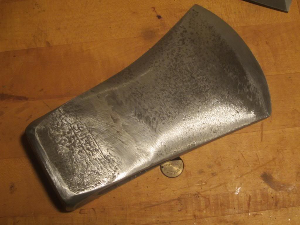

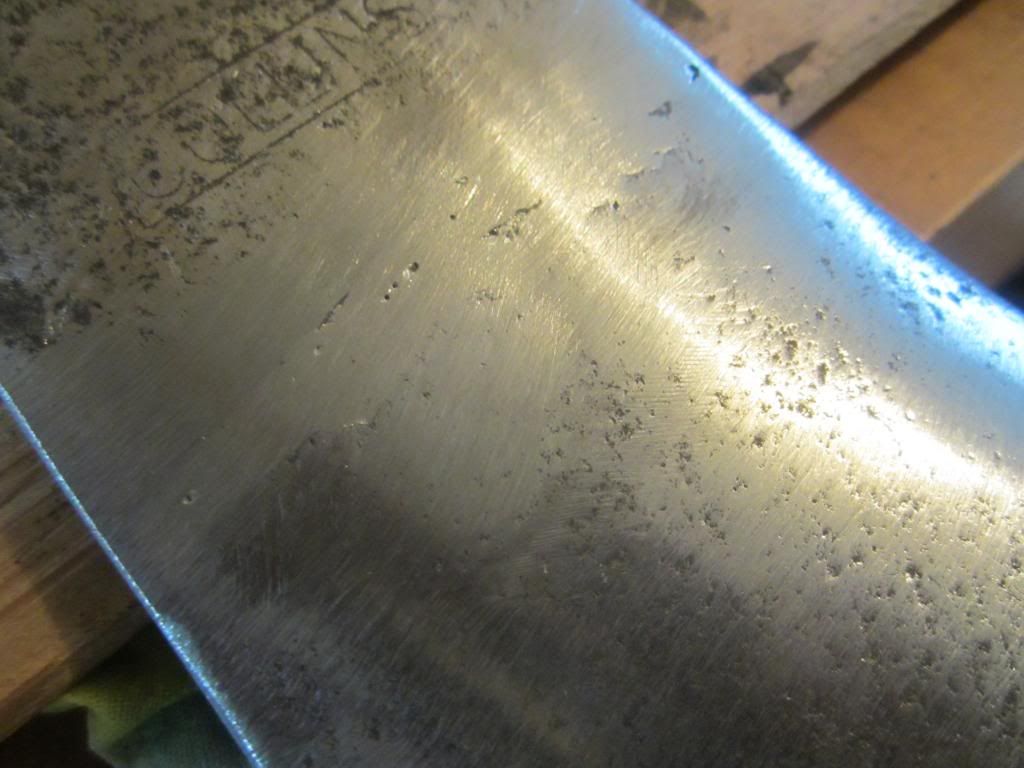

So, last weekend I went to the local metal recycler and I brought home what I thought to be a Collins rafting axe with a crack running the length of its eye. Normally I would pass on an axe with a cracked eye but I don't have a rafting axe, the price was right and it seemed like a fun challenge. After hitting it lightly with a fine wire cup brush the makers stamp clearly revealed itself and sure enough this rafting axe is a Collins.
I then soaked it in distilled white vinegar for a couple days while periodically removing it to hit it with the cup brush, lightly sanding it and returning it to the vinegar bath. During this process I noticed something peculiar about this axe head. The vinegar bath revealed no heat treatment lines. I was expecting to see distinct lines across the cheeks and at the poll but there was nothing. In fact, while soaking in the vinegar this head turned quite black and uniform in color almost like the whole axe head was hardened.
Could this be the result of the axe head going through a fire? Then after it was rehafted someone eventually used it as a wedge? When they smacked it with a sledge or whatever it cracked because it was too brittle? My question now is if I get the eye welded up, how do I fix the heat treatment and tempering so that its hard and soft in all the right places?

I would guess that the crack was caused by the freezing of a soaking wet handle.
It's a pretty straight crack and should weld up just fine. Wrapping both the bit and poll with wet rags during the welding process should preserve the heat treat. If you desire to re-heat treat the axe it will be a little tricky because you would want to harden both ends of a rafting axe. I have some ideas on this that I will add later.

Interesting - a Collins with ridges in the eye.....interesting indeed.

Well, it went to my metal artist friend today. He expressed concern that he might "burn through" the eye and/or leave a ridge from the weld on the inside of the eye that might be hard to clean up. I told him to be careful and I could clean up the inside of the eye with a file. After he grinds out a little material from the crack he said he will clamp the poll side to try to squeeze it back into better alignment with the bit side of the crack and then weld it up. I am pretty confident he will do a mighty fine job. We will find out in a week or so.
Your friend might be ale to set up some heat sinks on the edge and poll. You might not need to heat treat it. I'm looking foreward to seeing the result.

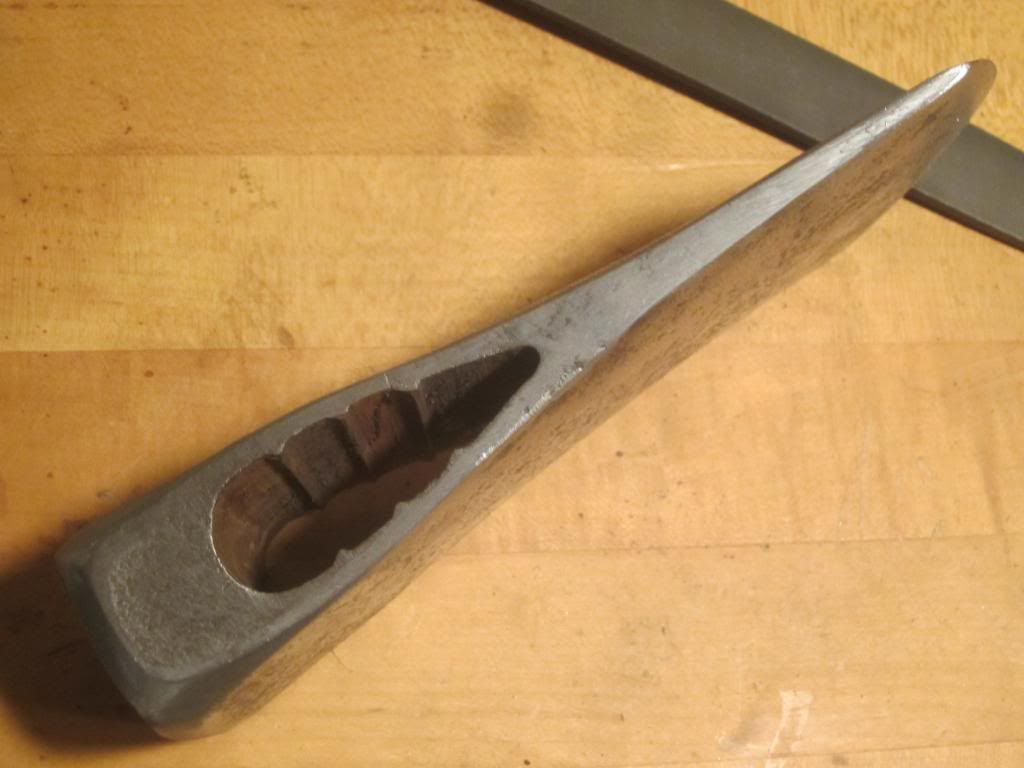

So, yeah. It has been welded and my friend even cleaned up the weld and, well, really cleaned up the whole axe head for me. I am doing work at his neighbors house so when he brought it over to me the thing was still quite warm from working on it. I was pleasantly surprised that he got it done so quick and at how it is looking. Now, I need to bring him a beer since that is all the payment he wanted.
He used stainless rod and must have been very careful not to burn through the eye. In fact, there is no evidence of a weld if you look in the eye, it still looks like a crack in there. I hope it holds. The thing rings like a bell, so that is promising.
I decided to go ahead and profile the bit and file the bevels on the poll before I heat treat it. I thought it would be easier than doing the file work after its hardened. The metal felt quite buttery under the file and material came of quickly.

I had a tomahawk head welded up and cleaned up with a crack similar to that,my buddy's got it now,never heat treated it after we fixed it,been beat to smithereens,holding up good. nice axe,good luck with her.
