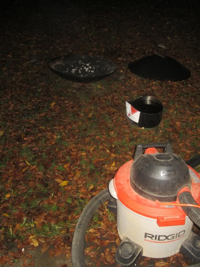

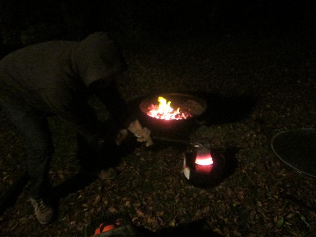

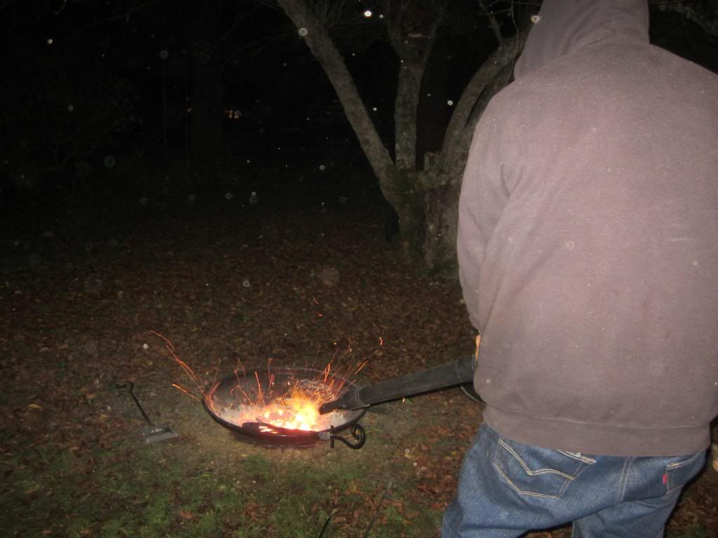

I ignored his advice and went with charcoal anyway, but first I needed to figure out this whole bellows thing. I thought of using my air compressor and an air nozzle as a bellows but decided that the thin stream of air would be moving too fast and might blow coals out of the fire. I figured a shop vac in reverse would be the way to go. Mine has an attachment with a wide flat nozzle approximately half inch by 3 inches. Here is my set up with the metal bucket of oil at the ready and the fire freshly started.
I also used the fireplace tongs, poker and shovel. One of those magnets attached to a telescoping pointer type metal rod that would typically be used to retrieved nuts or bolts dropped into difficult to reach places in an engine compartment was used to test for magnetism. I didn't really want to get my flesh too close to that red hot chunk of steel to test it for magnetism.

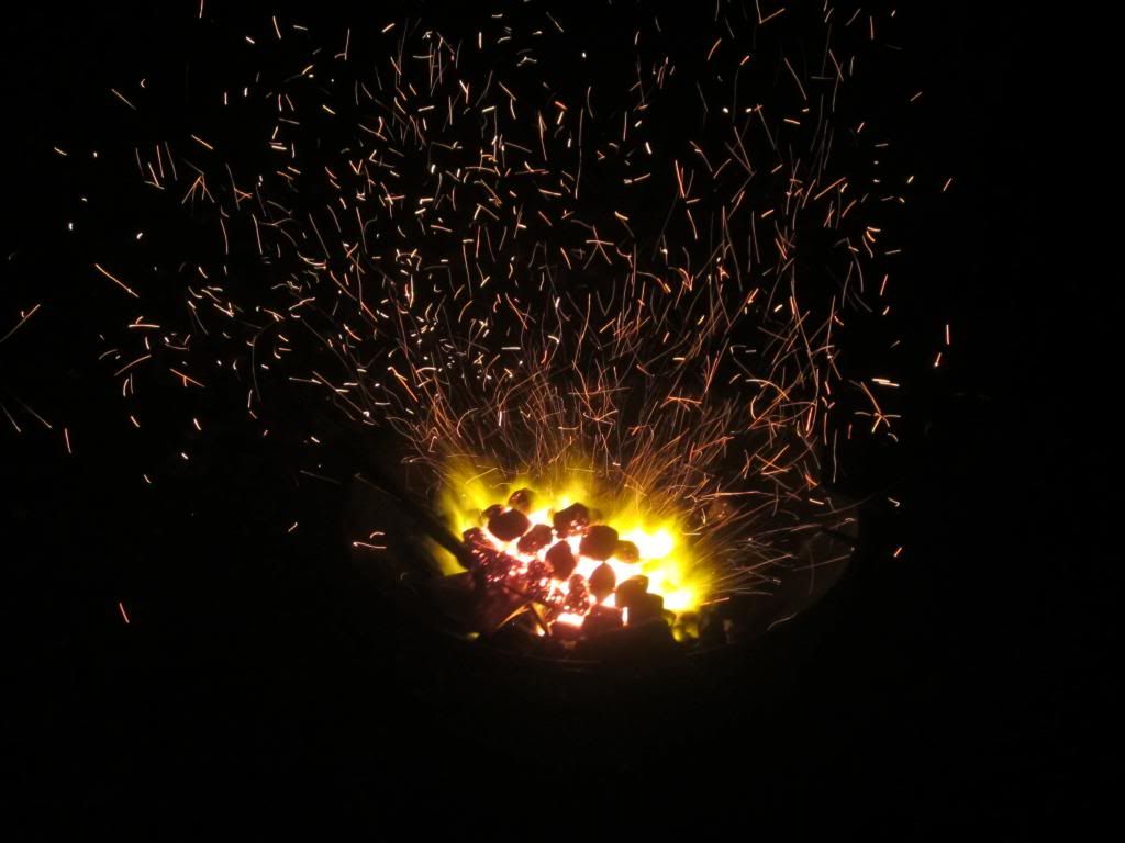

I got the fire going good and hot. Note, if you are contemplating using this open fire shop vac bellows method you really need room for the sparks to fly. Here I am bringing the poll up to temp.

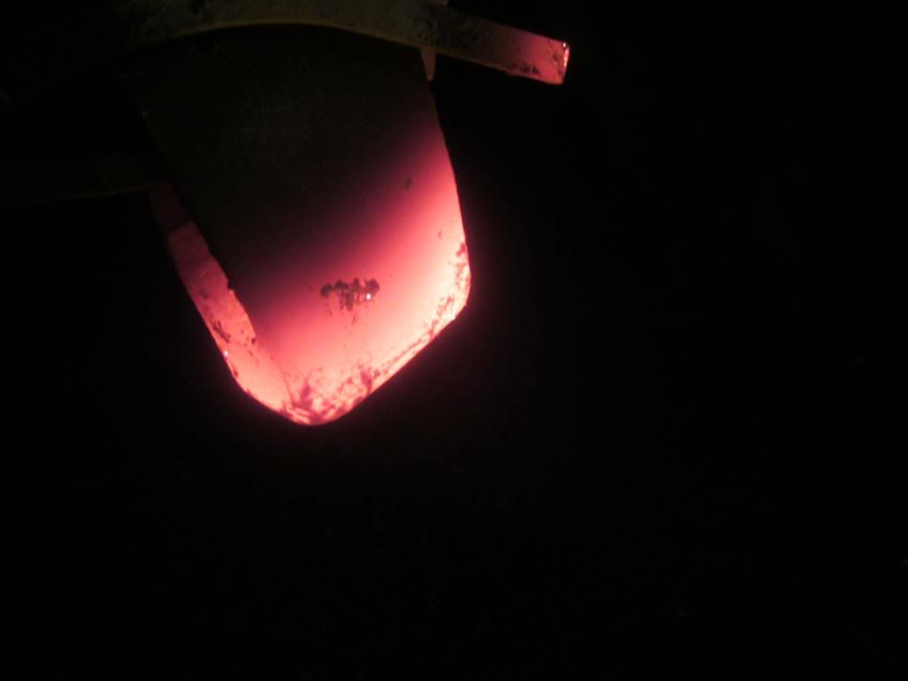

I opted for the two separate heatings method and heated the poll up until it was no longer magnetic. Here it is just before quenching. I have no idea how many shades past non-magnetic it was. This was done when it was dark outside tonight and the picture makes it look a bit more yellow than I thought it looked to the naked eye. All I know is it was freakin' hot and I was super excited that the magnet was no longer attracted to it so I quenched it.
Next, I heated the bit.

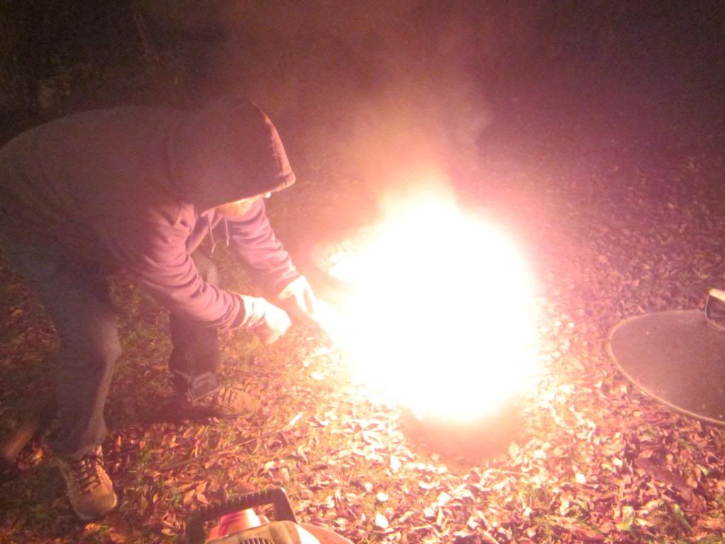

My wife was upset she missed the quenching of the poll so she came out and got some action photos for me. This is me and my bellows getting the bit up to temp.

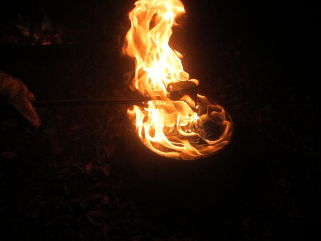

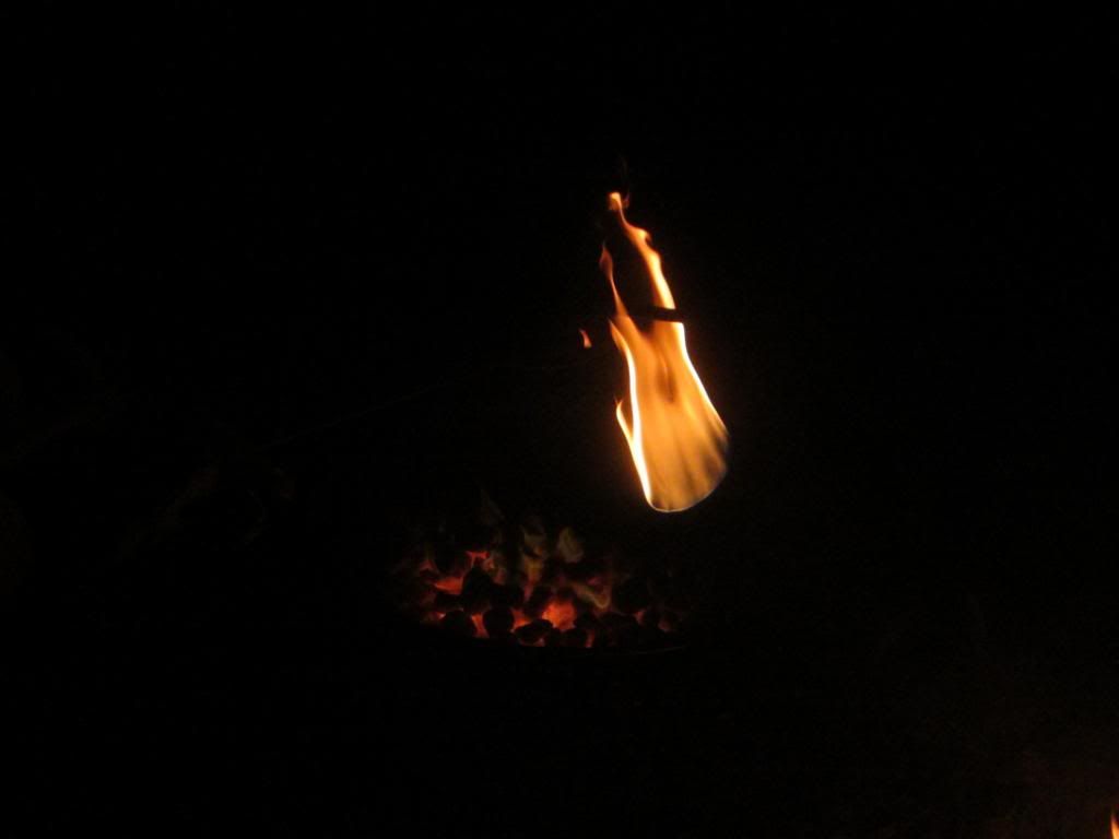

This part gets pretty intense when using oil.
It makes for some nice photo ops.

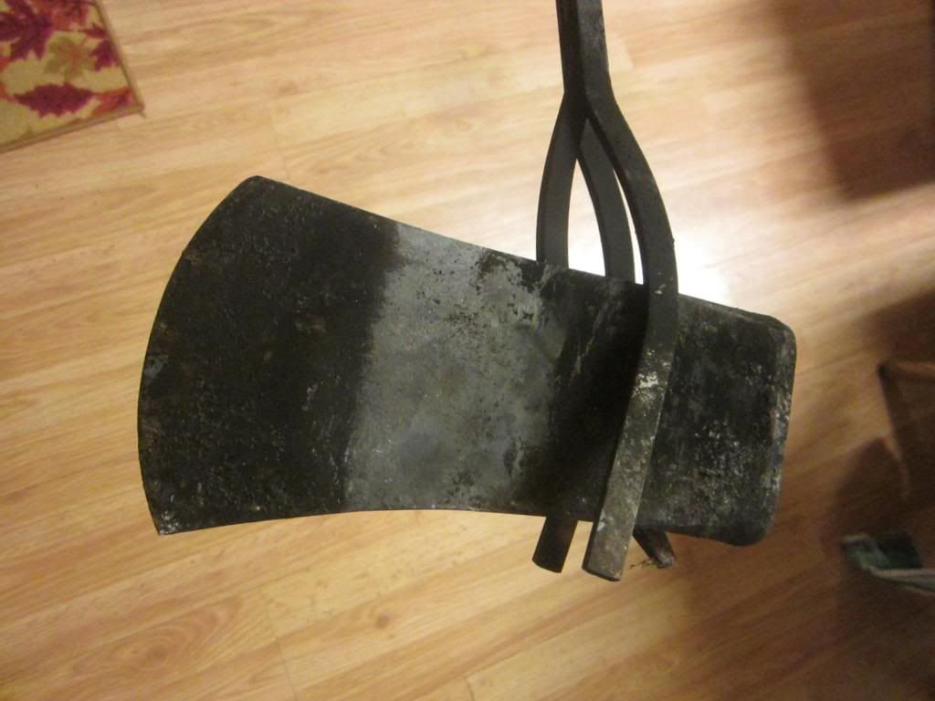

I have yet to clean the axe head up but this is what it looked like after 2 firings and quenchings.
It should be cool enough now to test the treatment with a file and then temper it.

It looks like you got it hot enough:) Did you try a file test?
Yes, I tried to file it and it was quite easy to file. I have a feeling that it was not hot enough.
I put it in the oven to temper anyway and its now just started cooling. We will see what it looks like in the morning. I guess I will most likely be heat treating it again, which was fun so I don't mind doing it again.
BTW, I would love to be using canola oil to quench it but I don't have a substantial amount of used canola laying around. If I start heat treating more items I will switch to something less toxic but for now since I have the stuff, motor oil it is.
edit: I did a little research and now believe that the problem was with my quench. I think my technique was a little off and that is why it didn't harden properly.
I have come to the conclusion that I definitely need to fire it again.
This morning I awoke excited to see what color it turned in the oven last night. I was encouraged that the bit was blue at the edge fading through purple to dark brown. Maybe it needs to be just a tad hotter for proper temper?
So, I touched it with my new Simonds mill bd file that has only been used to work one double bit. The Simonds cut fairly easily so I dug out a couple of my Nicholson bastards that I am more familiar with and they were having a harder time cutting it so I was starting to think it was ok and wouldn't need a new heat treatment. Then I decided it would be a good idea to compare it to the no name double bit using all the files. The double bit is much harder! Its back to the fire for the Collins crack head for more treatment.
I think what may have happened last night was that during the quench I didn't move it up and down enough. Apparently, leaving it stationary during the quench can create oil vapor that acts as a barrier around the tool impeding the heat transfer resulting in slower cooling of the tool. Moving the tool up and down slightly facilitates more oil contact and quicker heat dissipation. Luckily I didn't stir it in a circular motion either, so that is good. Stirring it during the quench can warp the tool and we all know that a warped tool is no good. Also, I may have pulled out too early (yeah, I worded that just for you folks with dirty minds). Anyway, I left it in the oil for about 15 seconds or so on each quench but the oil was by no means done bubbling when I lifted it out. I then put it back in to cool down more. This next round of heat treatment I will be patient and leave it in until the oil stops bubbling and move it gently up and down the whole time. Any thoughts on this would be much appreciated.

Judging by your earlier photo I'm sure you had plenty of heat for the quench. Make the corrections to your quenching process and I bet you'll be fine.
Also, if you weren't actively cooling the pole while heating the bit then you would have likely tempered the pole. If you polish a line of steel leading to the pole before heating the bit then you can watch to see if the color starts running to the pole and interrupt it with a few shots from a spray bottle. Or as a precaution just spray the pole occasionally during the heating of the bit without watching for color.
If you reach light yellow or white heat then you risk burning the steel and damaging it. If it starts to spark then you're way past too hot. Don't go past orange heat as viewed in a semi-dark room.

Another thought, I was told to use natural hardwood lump charcoal, rather than pressed/formed briquettes. It burns hotter, and more sparks.

I don't think I'd use the Jet Dry until I saw what water alone did. An axe bit is thin steel and it's very easy to make thin carbon steel too brittle. Oil leaves a softer core that reduces chipping and cracking but should leave the surface almost as hard as a water quench. Thin steel should be quenched in oil. If oil doesn't harden it then step up to water. Save the Jet Dry and other super-quench formulations low to medium carbon steels.

+1 And unless you oxidize the steel you can quench many times. One thought, you might heat up your oil to 175 - 200 F before you quench. That will reduce the viscosity of the oil and increase the speed of the oil. Keep moving the head like you wrote earlier. The first couple of seconds of the quench are the most important.
