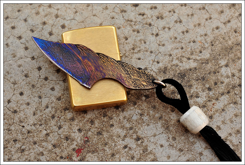

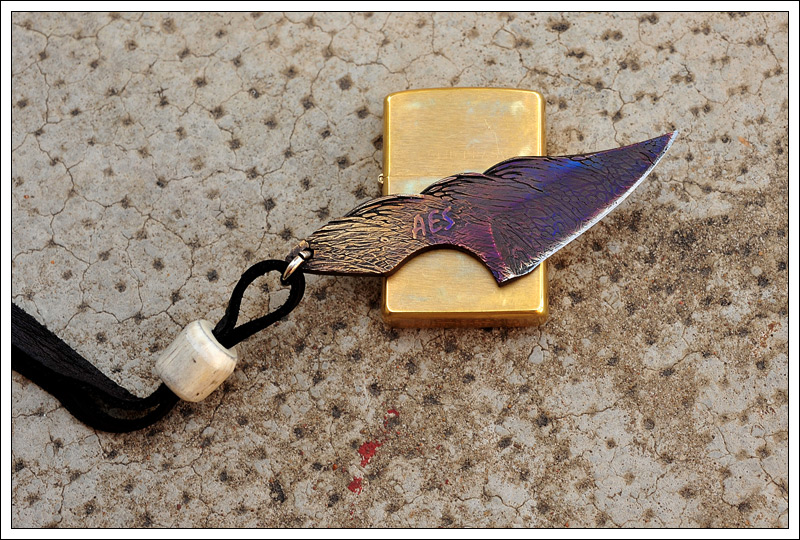

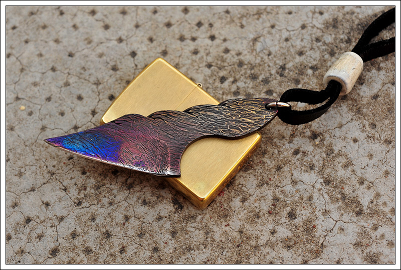

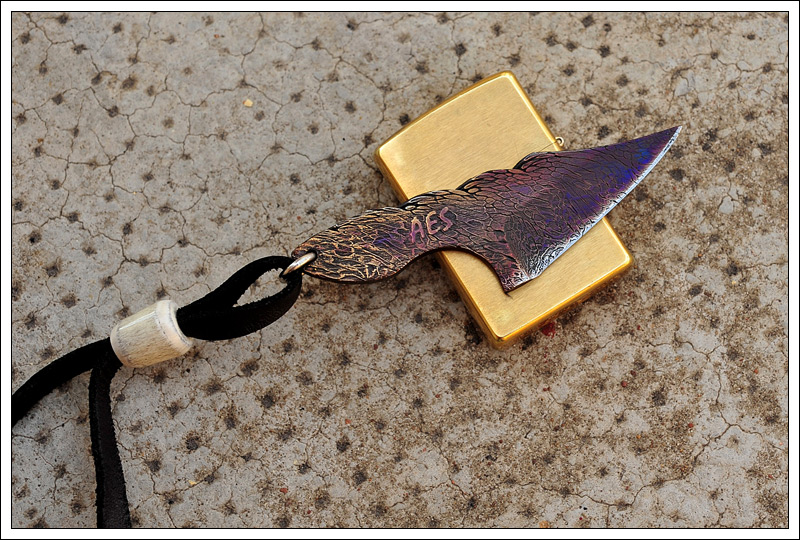

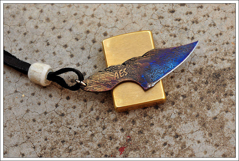

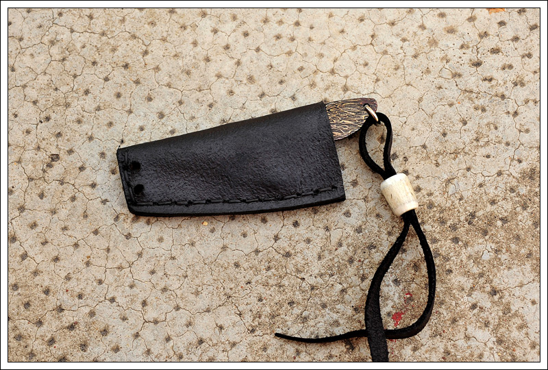

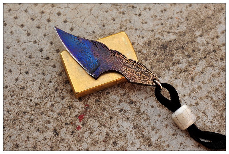

I really like how these four turned out :)
Cable Damascus Neck Knives
Heat colored cable damascus (1085).
Stag lanyard bead. Neck carry leather sheath.

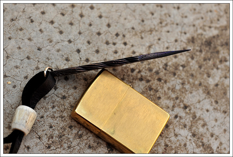

Top view
Sheaths

I was just commenting to some of these guys about your work the other day. Your work always amazes me.
Ariel, very cool work. How did you get the color patterns? if it was heat coloring, I would have expected the handles to be blue and the edges to be bronze/straw?
Just curious. They look very nice. Cable is such a great medium. You can leave it sort of intact, as you have here, or you can forge it out and get a little more reptile skin look. Or, you can fold it a few times and have something that looks like tamahagane, and the right pieces will also take a great hamon. Just wonderful stuff, and you seem to get the most out of it.
