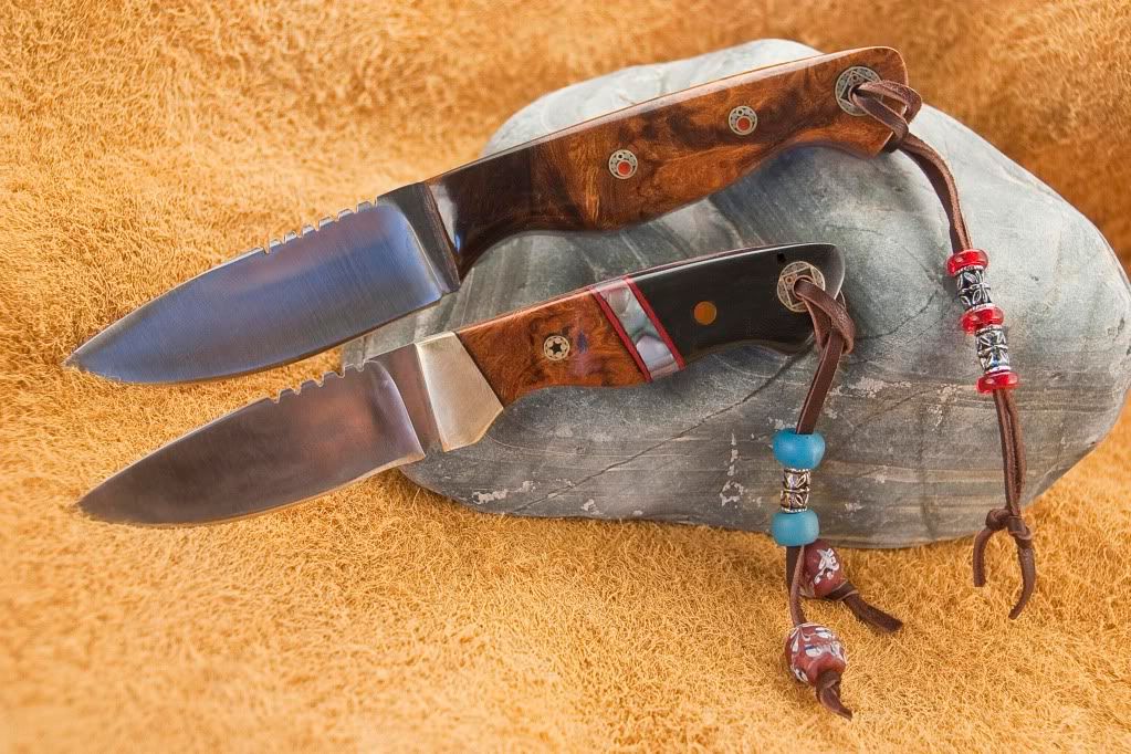

I have used some fiber optic rods in my knifes. Have mixed results, I guess they collect light from the sides and reflect it out the end. As a pin there is no light to reflect, but some end light can come thru. Was thinking it needs to go in a clear tube then use as a pin.
Anyway at the link below are sizes and colors. Hope this helps... and what do they say? This aint nutting without a Pic?
Top knife fiber optic inside a mosaic pin, second knife is a pin...
Here
