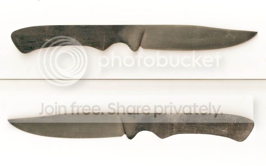

My elbows are feeling OK today so I have manage to do a little work on this blade.
I got it profiled this morning, ground the bevel and sanded it out to 320, but not finished with the 320, in this afternoon. I had to jump the gun a little and etched it with a little vinegar to see how things where looking
scanned image and PS'd to bring the etch out more
Dimensions changed a bit while getting to this point, blade measured from middle of plunge line is 4.2" and handle is 4.8" from same point on the plunge line to the butt. The over all stayed the same at 9". I made the mods after I made my first template so that it would fit my hand better
