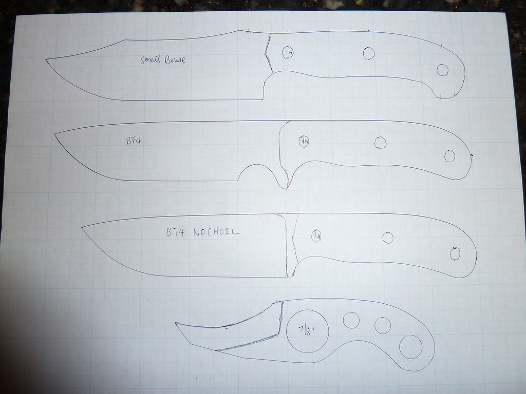

Here is my interpretation of a competition chopper. I plan on making it out of .320 stock so it will be a beast. Variations of different points (ie. drop, clip, etc...) will come out of this beast. I left the OAL a bit over 15" so that I can either shorten the blade or handle a tad to suit personal tastes.
More than several guys have asked me about a choiless BT4 so here it is. I shortened the overall blade length a bit because the blade looked a bit too long without the choil.
aaahhhh.. right on Ban... a choil-less BT4... looking forward to seeing it all finished up..:D that camp chopper is gonna look bad ass too...:thumbup::thumbup:
Very nice! I'm really liking the choil-less BT4 and the chopper!
I think I prefer the BT4 with a coil. Still interested in buying one when you have one to sell.
I'm liking that squared off chopper design - I watched some of the video from your get together and that looked like big fun.:thumbup:
Both look excellent Ban! What steel types are you thinking for the .32'' comp chopper?
I am thinking A2 initially. CPM Stuff in that size has a hefty price tag. There will be drop points and clip point variations of that design.
I'm diggin the choil-less BT4. Hope I can handle one at the next meet up.
That squared comptetition chopper at .320 would be a beast indeed.
I am starting to hand profile one of those Choil-less BT4 in CPM154. 2X4s were already shivering in fear as I was profiling that prototype chopper. The proto is a tad smaller and slightly different due to stock limitation.
Whaaat, only .320??:thumbdn:
Man I know you gotta have some .50 stock somewhere!!!
Haha... Just checked...... .50 thick 3" X 18" A2 is about 70bucks plus shipping. Gonna take some serious grinding though. I hate to find out what CPM-3V or CPM-M4 in that size would cost :eek:

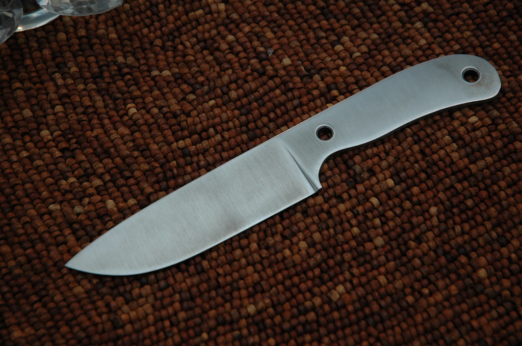

Decided to grind a Choil-less BT4 out of 1/8" thick 3V. Here it is rough ground and ready for Heat Treating. All I need is the dang oven now :grumpy: Been waiting close to a month now.
Looks sleeker ground out than on paper. :thumbup:
Reminds me of the outdoorsman, but wider.
Looking forward to seeing the finished product on the chopper:thumbup:
oohhh.. that look great Ban.. can't wait to see it all finished up...:D
