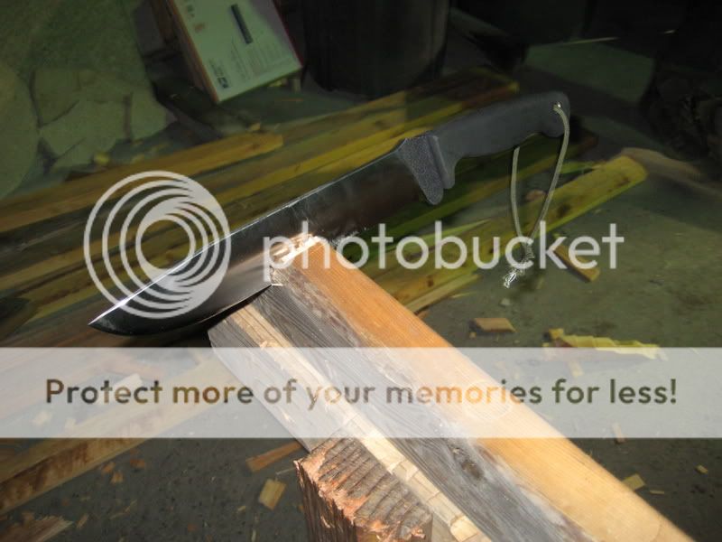

don't hammer on reciprene-c because you will split it. because it is made of rubber, which splits under severe crushing pressure.
I'm not trying to mislead anyone - you should never hammer a rubber handle, unless it's hardened plastic that's impact resistant: which isn't rubber. Micarta will chip if you do full heavy shoulder swings with a mallet - before that the tube fasteners will sheer. I can fix sheered tube fasteners with bolts and stand offs a lot easier and with better results than I can fix split reciprene-c.
I'm not saying it's weak - its strong as hell.
I'm not saying it'll split the second you start batoning it - if you use a medium weight baton it'll take many sessions before damage starts to appear
I'm not saying you shouldn't buy it - it's cheap, warm in cold weather, vibration reducing and resistant to most impacts and abrasion
I AM saying that you should treat it like what it is, hard rubber. You can't do to reciprene c what you can do to micarta, micarta is way harder and able to take much heavy impacts before failure.
