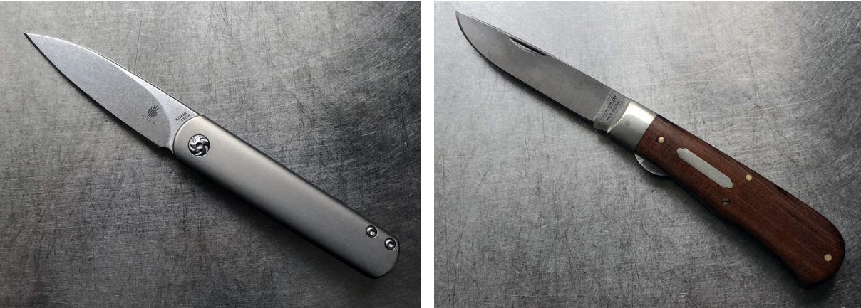

I was (probably still am) a modern folder guy until recently but switched to traditional carry lately.
Although I still love good frame lock knives, what I grab and put in pocket is a traditional knife.
Here, just out of curiosity, I compare a couple of small knives I like, a modern frame-lock production knife and a traditional slip joint (with liner lock) knife, to find out why I choose a traditional carry.
So this is a research in my personal preference and not to be generalized.
Anyway, these are the two knives for the comparison.
Specs:
Code:
  Overall length:                  165 mm (6.5”)                                                       175 mm (6.89”)
  Closed length:                   94 mm (3.7”)                                                        95 mm (3.7”)
  Blade Length:                    73 mm (2.875”)                                                      80 mm (3.15”)
  Blade thickness:                 2.75 mm (0.108”)                                                    1.93 mm (0.076”)
  Blade width:                     20 mm (0.79")                                                       15 mm (0.59")
  Edge thickness:                  0.5 mm (0.019”)                                                     0.18 mm (0.007”)
  Edge angle:                      20 DPS                                                              20 DPS
  Blade material:                  CPM-S35VN                                                           1095 (carbon steel)
  Blade grind:                     Flat grind                                                          Full flat grind
  Handle thickness:                10 mm (0.39”)                                                       12 mm (0.47”)
  Handle material:                 Titanium (bead-blasted?)                                            Osage Orange cover, brass liners
  Weight:                          75g (2.65 oz)                                                       78g (2.75 oz)
  Lock type:                       Frame lock                                                          Slip joint with liner lock
  Deployment method:               Front flipper                                                       Nail nick
  Pivot type:                      Ball bearings (caged)                                               Direct liner contact
They are both great knives with their own goodness and shortcomings.
Pros:
Code:
                                   1. One hand opening.                                                1. Thin blade.
                                   2. Pocket clip.                                                     2. Thin edge.
                                   3. High-end stainless blade steel.                                  3. Narrower blade.
                                   4. Open construction.                                               4. No accidental opening.
                                   5. Can be disassembled.                                             5. Edge protected when closed.
                                   6. Durable handle material.                                         6. Natural handle material.
                                   7. Better finish (modern machining).                                7. Double locks.
Cons:
Code:
                                   1. Thick blade stock.                                               1. Two-hand opening.
                                   2. Thick edge.                                                      2. No pocket clip.
                                   3. Edge too accessible when closed.                                 3. Carbon steel blade.
                                   4. Potential accidental opening.                                    4. Pinned construction (no disassembly).
I like the ease of operation of Feist (and other modern folders).
But there are two things annoying me.
First is the ease of opening.
I had it open accidentally in pocket, multiple times.
It too happened to other modern folders, of which blades are kept closed with the detent ball.
In contrast, I am pretty much worry-free with a slip joint knife which has a strong spring like the GEC.
Second, the blade is not slicey enough to me.
Feist has a relatively thin blade, but still it is way thicker than most of traditional blades.
The edge is also thick, which is typical of modern folders in general.
Once getting used to the cutting ability of traditionals, it is very hard to go back to modern blades.
I am a bit tired of chasing a slicey frame/liner lock knife......
The GEC doesn't offer a pocket clip nor one-hand opening, which I thought absolutely necessary for a folding knife.
In truth, I find them really unnecessary in daily cutting chores.
To sum up, in my case, the cutting ability and the secure blade closure are the main reasons to choose a traditional slip joint over a modern folder.
Would you choose a traditional over a modern folder, or vice verse, and for what reasons?

I think that's what it comes down to. A small gentleman's knife like the Feist does not require thick blades. There is no possible use you could want it for that could even suggest such a thing. So why are these blades being made thick? Thick at the spine, thick behind the edge. It's such a shame that their full potential as EDC pocket cutting/slicing tools is not being realised.

I suspect the blade thickness on the Feist is to better facilitate the flipping action. I look at my new Boker Urban Trapper and the blade is thicker than I think it needs to be. To top it off, it is a flipper that is not a great flipper. You have to snap your wrist to flip it open... okay, but it could be easier.
Miso2: You pretty much described the difference between a traditional slip joint and modern knife design. The potential for a knife to open in my pocket is disturbing and the opening action may help or hinder such things. My solution is to carry both. I generally avoid knife designs that might facilitate opening in my pocket from just pressure exerted from say bending over.... I absolutely hate when the alarm goes off in my one vehicle because of pocket pressure on the opener bending over and so forth.
Added: Take a look at the Fox Gentleman's knife....thin and a lot more knife than you would think from the size and shape. I like it.
I did not think about the weight of the blade to add the momentum for the flipping action. You may be right.
Then, it is still a shame to short cut to achieve the best action by thickening the blade rather than by refining the machining.
Regarding accidental opening, I had a flipper open in my jean pocket when I crouched down. Since then I am a bit too aware of this possibility.

I would and do all the time (then I bounce back to the modern and visa versa). Truth be told I carry both most every day.
Currently my focus and fascination are on this traditional (put some M4 steel in it and I might even be persuaded to . . . well you may have already heard my rant) . . .
Why ? I like long skinny handles and fairly long skinny blades that are thin (1.9mm at the spine for up to a 4inch blade length . . . believe it or not . . . but it is true).
Sure I like bigger handles and blades but that would look like this
Not like this
I carry some form a slipjoint daily and have for years, but lately I've been needing the convenience of pocket clips and one-hand opening.
Thick blades and impractical geometry is why I tend to steer clear of modern folders, but the lack of variety of steel choices with traditionals has me coming back .
I have a Buck Vantage that is extremely slicey due to its deep hollow grind and a Kershaw Leek that is as thin as many traditional knives. These two cut just as well as any slipjoint I own and have been seeing a lot of pocket time lately.

Regarding sliceyness, I found that the narrow FFG blade of GEC #73 outperforms the wide FFG Manix 2 LW, presumably due to the thin and slim blade (less friction) and the thinness behind the edge.
It even outperforms hollow-ground Boker Exskelibur I, and I think it is also because of the slim blade.
I guess I weigh more on the (subjective) slicing capability than other aspects of a knife.

I have an Urban Trapper. The light blade is a factor, but the lack of a good detent is a bigger one. If they had a stronger detent the blade would fire out and weight wouldn't be as much of an issue.
With the Feist, this isn't a factor. With a front flipper, the blade doesn't fire out in imitation of an automatic. The thumb keeps constant contact with the fipper, at least every way I've seen a front flipper being opened is like that. So a laminated paper blade should open just as well as a depleted uranium blade - weight for the sake of momentum shouldn't be a concern.

i’m a modern folder guy, mostly for the following:
One hand opening. While not always necessary, it tends to be very convenient. I’m also a bit jaded from hard to open nail nicks.
Pocket clip. There is always tons of junk in my pockets. I don’t want to fish around in there for my knife.
That said, IMO most modern folders are thicker than they need to be and grinds are often more about image than performance.
My SOG Zoom-mini performs exceptionally in spite of what some (including myself) consider a “barely adequate” steel (AUS-8). Why? Blade stock is .10 and the grind is slicey. That blade in m390 would be insane.
I will say the idea of comparing a traditional and modern is nice but the comparison is less about the tangible qualities and more about the experience which is more subjective.
You can fire out some front flippers.
Anyway, as 4Mer_FMF said, the manufacturer's decision to make overly stout blades might be more for marketing than for performance mostly.
I admit that sometimes I wish I had a pocket clip on a traditional-style knife.
Then, there are so-called "modern traditional" folders lately, some with pocket clips.
I have been looking at them and found that most of them are overly thick at the spine of the blade and at the edge bevel.
Hope that the "tough like a tank" plague does not spread to traditional pocket knives.
But I have already seen some custom slip joint knives with 0.13" blades.......
