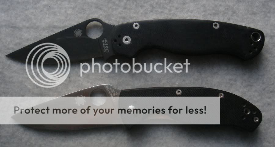

Oh Man.. Why Didn't I Think To Post Pics Of My Para 2 And Tenacious?
It's Not A Side By Side.. But You Can Tell The Differences.
All In All.. They Are Both GREAT Knives.
The Tenacious... You Just Can NOT Beat It For The Price.
The Para2 ... It's An "A" Class Knife And Really Amazing, And Well Worth The Money.
The Tenacious In My Opinion Can Beat Out Knives In The $50 - $60 Range, And That's Saying A LOT With It Only Being $30, Made In China, And Cheaper Steel!
Either Way, I Own Both, And Am Very Pleased With Both.
