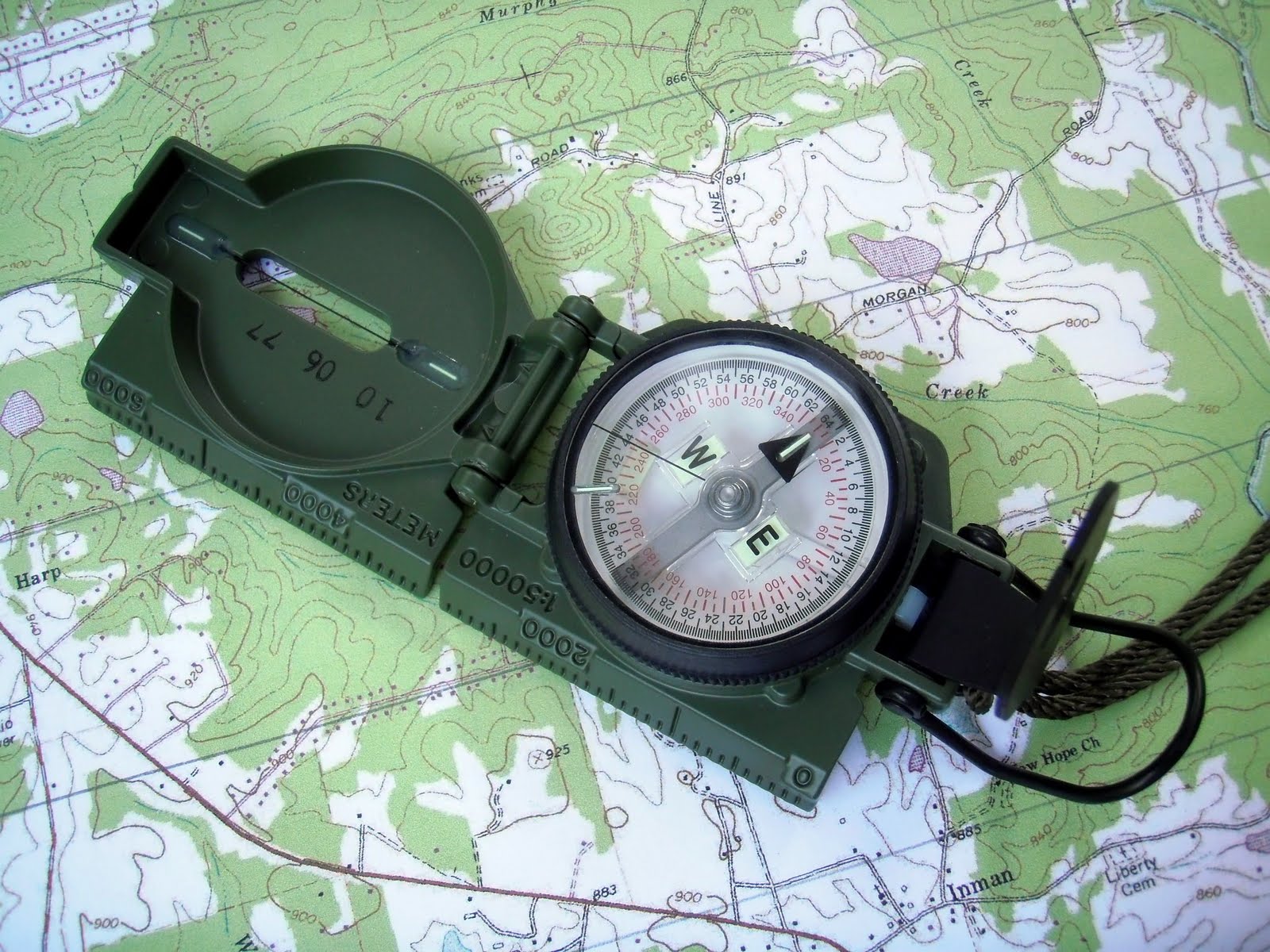

I use this one:
and here are the directions to use it:
http://outdoorproducts.com/wp-content/uploads/2012/09/Lensatic-Compass1.pdf
