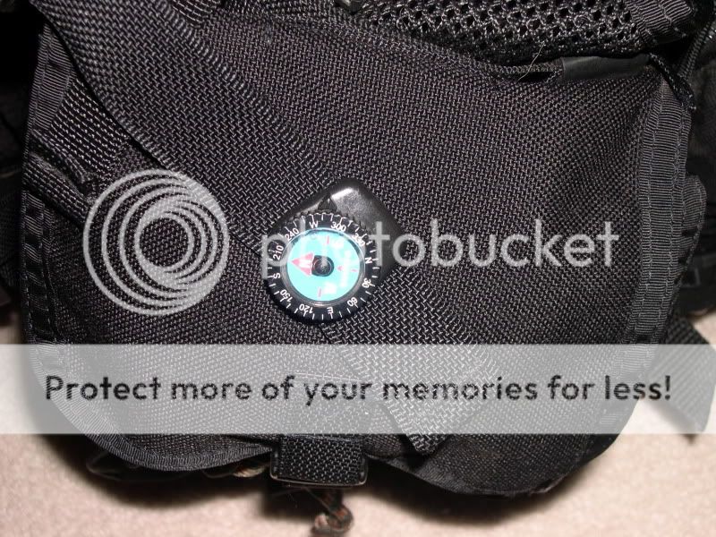

For saving my ass I always carry this nice and simple very basic compass everywhere I go:

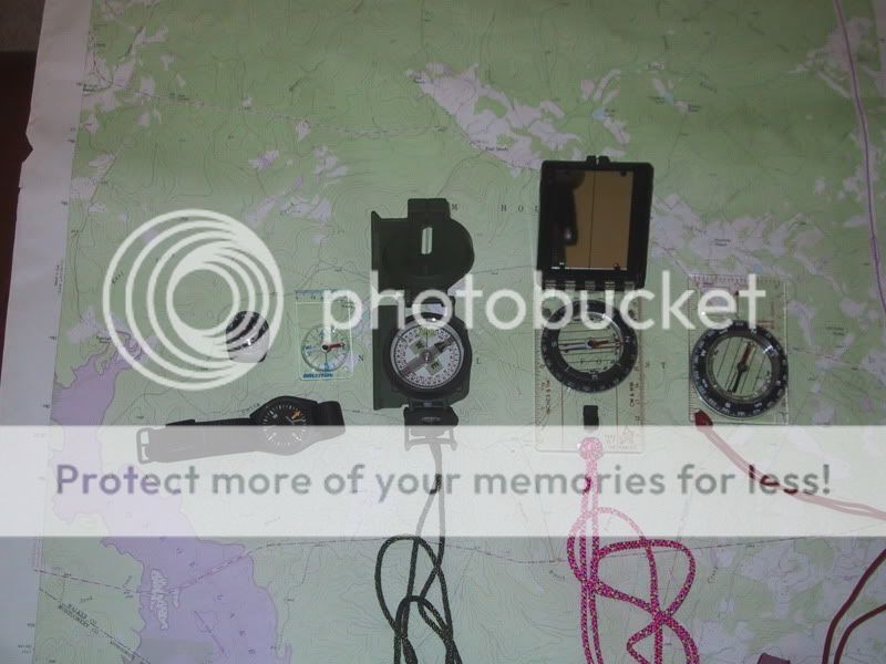

A sampling of my compasses. Some are missing. I love the 8099 and I don't find the parallax an issue. I don't find it difficult to make corrections for it by adjusting your view of the circles. It is a daytime compass though unless you possess external illumination. The box of 30 compasses I use teaching classes to CERT teams and Fire departments, SAR teams and orienteering students. The military compass was the one I used in the Army and taught Cavalry scouts with and for my own military use as a squad leader in charge of a recon squad. The Swiss army compass is also a great box compass that I really enjoy using also. I have a Silva Ranger 15CL somewhere that I have used for years, my wife bought me the first year we were married and was doing a lot of orienteering then. Another really good compass.

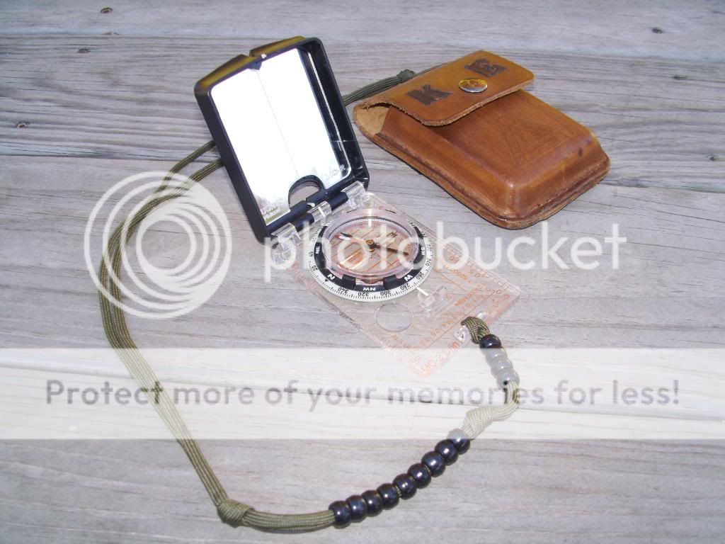

Personal favorite and most recommended, the Suunto MC-2D.

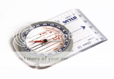

If I need something more precise, I rely on my 20+ year old Silva Ranger.

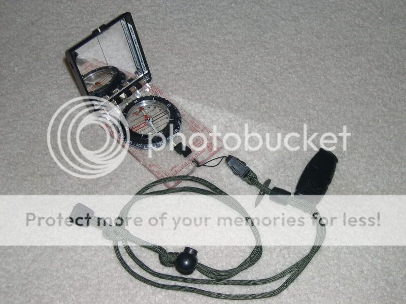

This is what I go to when I grab a bearing off a map, or follow one in the woods. It's my SAR compass.

Here's my Ranger:
I like the Suunto MC-2DL. Which is essentially the same as the old Silva Ranger.
The current Silva Ranger is made in Indonesia, and is not the same quality as the old Swedish Silva.

HornyToad: Can you identify the wristband compass in the lower-right position in your picture? -- Bear
