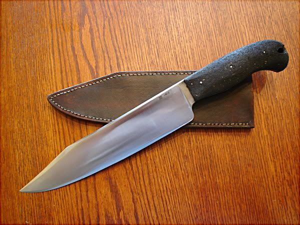

Here are two I've done and posted before but figure i'll throw em out there again:
1/4" O-1, exhibition ironwood, Paul long sheath
