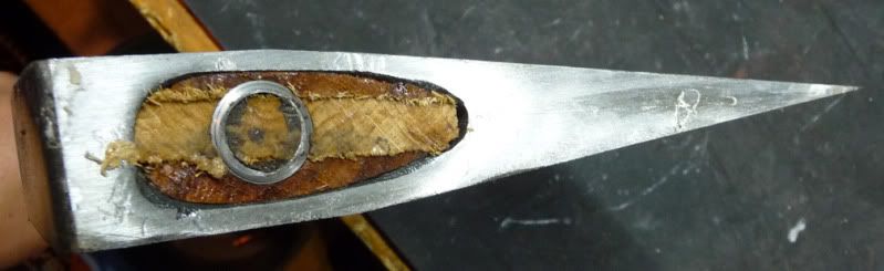

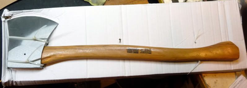

The handle and head were varnished. The head was nicely ground and symmetrical but rough. There were burrs on all the edges. Handle grain was poor, nearly perpendicular to the head.
This is as it came out of the box:

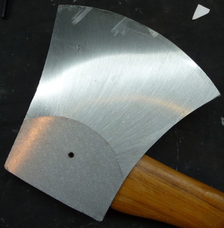

The blade was pretty dull so I tried to sharpen it. After a few passes with a stone, I noticed a jagged or serrated edge forming. Upon closer inspection, I discovered, what I will call, micro-voids in the edge. I ended up filing down the edge and stoning a new bevel.

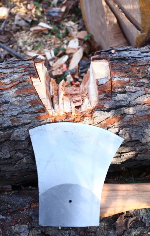

We've had a lot of downed trees from heavy winds and rain this fall, so I tried the axe out on the trees that I had to clear. As far as usage, I thought the axe performed well. It certainly is heavy but it bit deeply and I didn't find it hard to control, in fact I think the weight aided in control. I don't think that I could spend the whole day using this axe but the short time I did spend produced some good results.
Overall, I like this axe. It's not practical for packing into the woods but for clearing trees in the yard, I'd say the weight could be used to your advantage. I was a bit disappointed by the condition of the factory edge, but it was correctable with a little work. I ended up taking the varnish off the head and sanding down the roughness of the grind towards the blade.I'm not opposed to putting a little work in to clean up a rough tool, so it ended up being a fun project for me. I'll need to use it more before I pass final judgement, but so far I'm enjoying it.
