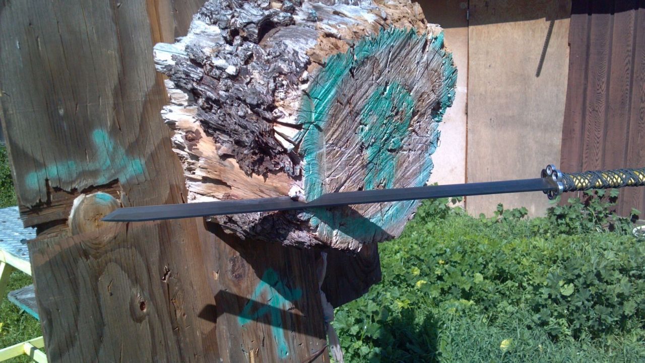

I forgot to post this picture up a day or so ago. We have a stump that we like to throw things at in our back yard and we swung the sword at it.
