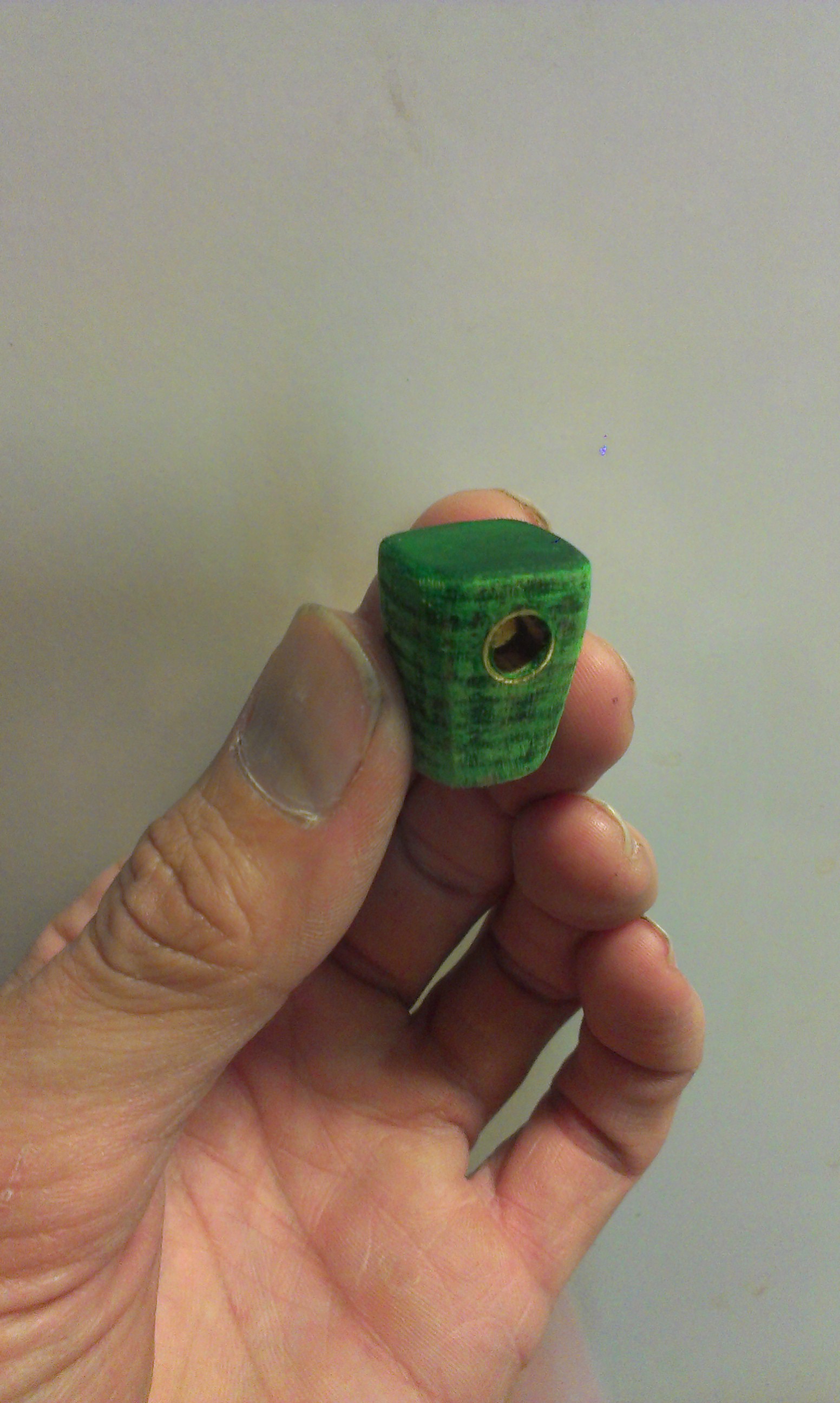

Playin with green dye. Not sure if it's a win or a train wreck.

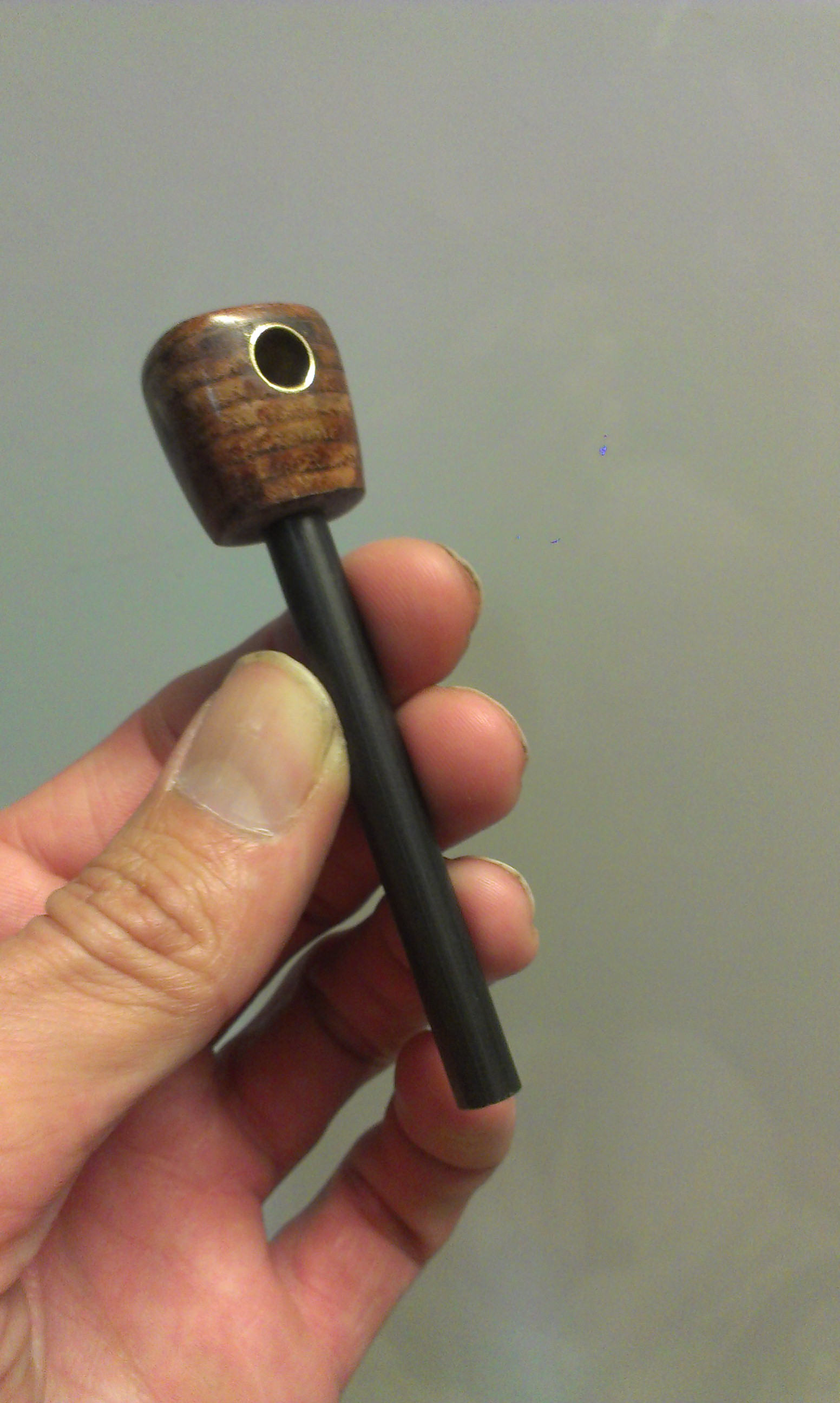

Rods showed up. Bigger and heavier than I thought, but in a good way.
That's my personal steel. The rest (other than the Green Man) will be a bit bigger.
Twisted- just to follow up on our email- I had to drill the pocket on the first one a bit bigger than I'd have liked. I didn't get it perfectly straight so,keeping the shape of the hole on entrance intact, I drilled a little extra out to center the rod. I decided to pack the cavity with jb weld and jammed the rod in. I've really gotta believe that it won't come apart. If it does, something went very very wrong. ;)

Thanks for that. I've been testing acrylic impregnation (ca) and am getting good results. The look suffers because you lose a great look that I'm getting by grinding a certain way with the drum sander, but stability increases immensely. The handle also (obviously) loses the nice feel of leather. After the ca soak it feels like a rock hard block of plastic, but again, I feel the durability is worth it.
I'm still playing with it. I'm trying to see how much of the surface can be sanded away while still retaining stability. I'm thinking that I can at least get back some of the look, and maybe even a tiny bit of the feel of the untreated leather while retaining an acceptable amount of the stiffness.
