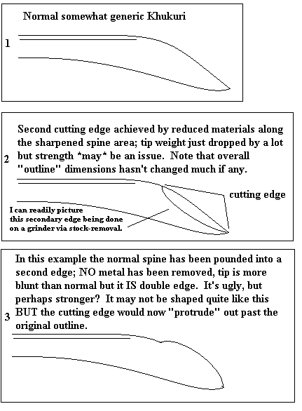

Aaaaanyways. Bill, the biggest question on doing a piece like this is tip strength. The water-quench process would be radically different than anything traditional and the changes would be right at the all-important tip area. Any guesses whether or not they could deal with it?
Someone else alluded to the idea that once they sharpen the spine, they're liable to try and get there by "pounding the hell out of an ordinary thick spine"...that would lead to...something fairly funky.
I think a pic is in order:
As you can see, there's two ways to skin this cat. I would *prefer* option #2, where tip weight drops via a stock removal process but if that leaves the tip too weak...it's possible the Kamis could do a better job with a "heat and beat" process as in option #3.
Especially with the stock removal process, it's clear we no longer have a woodsman's tool! It ain't gonna have the same heft or strength...this is more like the outer half of a Mad Dog Panther grafted onto the back half of a Khukuri than anything else.
But my GOD what a fighter.
Comments VERY welcome!

I have one of the 17" village Sirupatis also.This is the one I said made me want to get naked and do some exotic ballet and I ain't graceful.
I am however 'ful'
You got it Jim.
Take the steel from the spine and push it into the center for the strength.This all gets relative though somewhere in here.
I think I see a little more of where you might be going with this and in that case I would agree the grip is perfect.I was applieing my own (or used to be anyway) style.I need to learn a new way for my age,abiity and strength.
The part about lifting the tip is valid though,but let me back up on that for a bit,sorta
There is a very subtle difference between the 20" Sirupati and the 17" one I have.I hadn't figured it out until now.I laid the 17" on top the 20" and it jumped out at me what the difference is.
The 20" is sorta rounded off toward the tip from the beginning of the angle.(kinda like a drop point.)
The 17" is straight from the angle out.
It makes quite a bit of difference in the positions of the points on the 2 blades in relation to the handle.The 17" is higher and that is where I was suggesting the lift from.
Such is the differences in hand forged blades.:-)
The top edge hardening wouldn't be too much of a problem for these guys I don't think.They are very savvy.
It would mean that the whole point would be hard though,like you said.
The center of the blade would or should be the same.
I have to conceed with what you would desire in this case though because it is your wants that are important in your knife.

Hmmm. So regarding how to get the secondary edge, what you're suggesting is to use "heat'n'beat" but instead of "spreading the material outwards" from the spine, "pound it in towards the middle".
This would keep the overall outline similar to what it would otherwise be?
Sounds OK. Would there still be overall less material under this plan, or are we talking about the same amount of steel just "redistributed"?
As to the tip position, I agree that so long as nobody tries to hook the tip UP from the spineline out past the crook, we're OK. In fact I think the picture I first drew (picture #1 and preserved in pic #2) is exactly as you describe the 17"er, right? I think weakness would result only if you tried to twist the tip UP any higher, and that's what I first visualized from your earlier words. I think we're on the same page now.
I think if we start with the lightest type of traditional 20" piece we should be OK if the heft is the same on this critter. A hair lighter from a stock-reduction process on the secondary edge would be cool, but only critical if we started with an Ang Khola or something, which methinks would be a very bad idea.
So which is lighter: a 20" Sirupati, or 20" Chaimpuri(sp?)?

Thanks Rusty.
Rusty has supplied the weight info needed.
Jim if you will go back a few days on the posts to the one "Yvsa resurects a 20" Sirupati you can kinda see what I mean about the point curveing down from the angle.If you started at the beginning of the angle and kept it straight the point would be some what higher.
I think we are on the same page to now.
The first 2 paragraphs in your post are right on.
If the material from the spine on say a 20" Sirupati was moved down to center to lengthen and forward to also lengthen,which wouldn't be much. It would give the strength you are looking for.
What you said explained it better than what I am trying to say I think.
It may be just a little thicker there than the fuller behind it.
I know!! Kind of like the fuller on a broadsword only with the Kuhkuri curve and a spine on the top side running into an edge.
That may be the best way to describe it.

Yvsa, I think we ARE on the same page re: the tip construction.
OK...one last thing that you and Rusty can probably help with. Rusty put up a "chart" of weight of various types:
1) Sirupati
2) Sirupati bladed villager
3) Sirupati bladed/Chainpuri handled villager
4) Chainpuri
It sounds like there's a major weight factor in the *handles* here? Errrr...hmmmm. This is where my lack of experience is liable to get me in real trouble...what are the differences in grips? Are there any pics of the Chainpuri up somewhere? How would the Chainpuri grip compare to the 15" horn Ang Khola?
It sounds like the Chainpuri should be the starting point, especially if we use a "heat'n'beat the spine material towards dead center of the blade in the tip area" process to get the desired second edge. If we use a "stock removal with a grinder" process we should probably start with the additional heft of the Sirupati to help increase strength but I *think* Yvsa's suggestion of a heat'n'beat process has more going for it.
