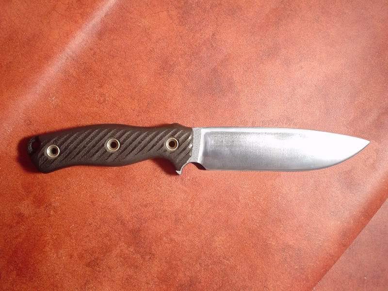

So, my concept is to come up with a M6 sized blade that is lighter and more suited for mid-sized general tasks. I don't feel a knife with a 6" - 6.5" blade is ever going to be a great chopper. But, there are many good uses for a blade this size if it is balanced right. (IMO).
So, I will combine my favorite details of certain knives...:
- SJTAC blade shape - Full height grind (or nearly) AND Convex!!!
- Ratmandu handle shape, but slightly taller and a tad longer for a slightly larger knife. Not as bulky as the M6, but more scale thickness than the SJTAC.
- Pull the choil in closer for better comfort when choked up and more blade edge.
- *** Skeletonize the handle under the micarta scales!!! - Since the Swamp can obviously skeletonize the tangs, I consider this an option that would greatly improve the balance, feel, and weight of a knife this size and STILL be plenty strong enough!
- I don't feel that a knife this size needs to be as thick as the M6, but that is a personal preference and subject to debate and intended use. Since I don't feel this would be a good chopper and I do consider it to be more of a larger general use knife, I would prefer less than the M6's .234" thickness, but maybe a tad thicker than the SJTAC's .194" - So, somewhere between .2" and .21" (???) - Since I propose skeletonizing the handle, the handle of the concept knife should be considerably lighter than the M6's and the blade would probably be similar to just slightly lighter than the M6's blade. I would think the concept knife could net out pretty close to the 13.0 ounces of the SJTAC. The slight weight increase by increasing the steel thickness and scale thickness would be offset by the skeletonized handle and net out about the same. The SJTAC balances well.
- I humbly request a satin LE option.... ;)
Rat Jack Concept:

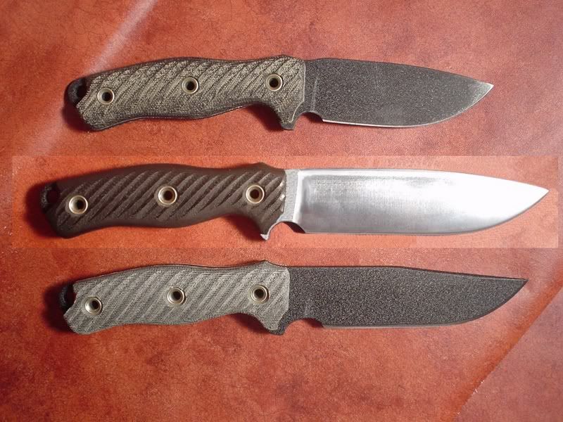

Next to Ratmandu:
Between HRLM and Ratmandu:

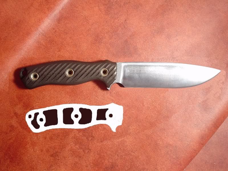

With concept sketch of skeletonized tang:
... notice the cut-out areas have rounded inside corners to help reduce weak-spots! ...... I assume Busse has the blanks laser cut (????).

- Skeletonized tang
- Similar handle to HRLM/Ratmandu, but slightly slimmer handle proportions - height and thickness
- Blade shape similar to Bog Dog, but with slightly less drop than older Bog Dog and slightly more belly, but still pointy - see comparison pick of Concept Bog Dog II vs. older Bog Dog - or basically a smaller version of SJTAC blade
- Choil in closer for better comfort when choked up and more blade edge.
Concept Bog Dog II
Under HRLM and above old Bog Dog and Ratmandu:

Love the Bog Dog 2 concept design. If it feels anything like the HRLM, it would be a winner. Thumb depression on spine like the HR would be nice.
You, DWRW, are a concept-chop master! I like the Bog Dog concept A LOT! But the Rat Jack?! Awesome!!!
Great ideas! I would love to see this come to fruition.
Knifeguy, I really like that Rat Jack Concept you've got there. It looks like a great camp knife.
I've never held an M6 before, but my RMD feels well balanced at about the first fastener. Don't know if thats true for the M6, but I would think a skeletonized tang in a larger blade would shift the balance forward? Wouldn't this make a big blade a little nose heavy for a non-chopper?
Also, I like the reduced choil and the full height grind. Nice job.
Thanks Iuke12, I am glad you like it.
I agree with the thumb depression. I sort of drew/edited/photo-chopped the thumb depression into my photo. It isn't visibly real obvious, but if you look closely you can sort of see it on both concept drawings.
I like the thumb recess on the HRLM a lot, BUT I would want the ramp to be the exact same distance forward of the lower grip/guard area.
I like thumb ramps and recesses If and ONLY if they fit right. The HRLM and Ratmandu do fit right (for me). But, many other knives with ramps have not been good for me. I don't like when my thumb falls on the peak of a ramp.
The Yard Guard and SJTAC are two examples of where I didn't like the position of the thumb ramp. I have had to grind away and reshape those thumb ramps.
I also have a two tone Dog Skinner LE from Extraveganzaaa. It is a gorgeous knife, but the ramp is off for me on it as well.
If it is done right, I like it. If not, it is annoying.

HoleyM,
I don't want to make it sound like I am some sort of fanatic about balance. But, I do have certain balance and feel preferences and they vary from knife to knife. My main issue with the M6 is overall weight.
The RMD actually balances very well and right between the first fastener and just a nudge forward of my index finger in grip. I don't have any real problems with this. But, I also have the G10 which is just a tad heavier in the handle. I don't really have any problems with the "Balance" on either of these knives. But, I wouldn't have a problem with this particular knife having a slightly more forward balance either. And I think just shaving some over-all weight would be an improvement. But, I wouldn't want to take any weight away from the blade on the RMD. So, the weight would need to be reduced from the handle. This would shift the weight/balance slightly more forward, but I think it would be fine.
Since Swamp Rat is pretty much micarta (and sometimes G10 now ?), my suggestion for skeletonizing the handle is the most realistic way.
There are quite a few knife-makers who have skeletonized their tangs, so I don't think there should be any concerns about idea infringement and the technique works well. The handle should still be way more than strong enough if the cut-outs are engineered half-way decent - relevant to the size of the knife and steel thickness, radiused corners, etc..
The HRLM balances just behind my index finger in a grip. This is OK, but I would prefer to shave an ounce or two from the handle if possible on the HRLM. I am pretty confident I would prefer this.
The M6 actuall balances just slightly forward of my index finger in a grip. This may seem ideal to some people. But, for me, I just feel the M6 is too heavy period.
The S6 is basically the same design as the M6 but, with a much lighter Res-C handle. It is not really a chopper either, but it feels much better in my hand. The S6 feels very nimble compared to the M6 which feels more like a heavy dumbbell (to me ;)).

In my concept for the Rat Jack, I suggested the skeletonized handle because it will reduce weight from the handle AND over-all weight. The blade-thickness that I recommended is thinner than that used on the M6 and should decrease some of the blade weight as well.
I believe balance and over-all weight as described would come out similar to my SJTAC (at least that is my theory). The SJTAC balances probably about .25" forward of the index finger and I like the feel quite a bit.
My concept for the Bog Dog II has a slightly smaller blade - similar in length, but not as tall, so less blade weight.
My concept also would have just a slightly more slender (in height) handle compared to the HRLM. This slight handle reduction would not change the handle weight much. But, I already beleive that a skeletonized HRLM handle would be an improvement (I still love the HRLM as is :thumbup: - just some little detail I feel would be an improvement). So, I definitely feel having a skeletonized handle would be an improvement on the Concept Bog Dog II!
I still think it would be very worthy on the Rat Jack as well.
