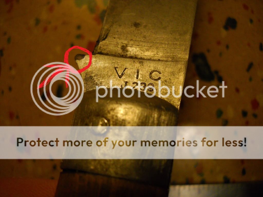

The ricasso has a kick at the top that hits the backspring, preventing the edge from hitting it instead.
Here's a pic:

I have read in a pocket knife repair book that if the kick is too short it can be adjusted by using a punch. I found this out on my first knife when I was a bit eager grinding the kick. Take a pointy punch and tap right in the middle of ConBons arrowed circle (see pic above). Tap lightly then check progress. The metal will slightly expand at the kick and a little goes a long way. I would not do it on an heirloom but it should fix a user. Nathan

Here you can see what I am referring too. Pardon the roughness, it was a prototype.
