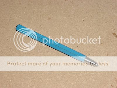

Don't know why I didn't think of it. It's just peening. When you have a press fit hole for a bearing which is cut oversize and is a slip fit you can just take a punch and go around the inside 3-6 (or so) times. It's probably stronger than locktite. You can make it too tight if you aren't careful.
What does the end of a "prick punch" look like ? I have accumulated a few punches over the years, so i may have one.

I love this forum. Thank you Robert! A dimple would look alot better. Yeah the punch I used probably has a 75 degree tip on it. I will make one with a flatter angle but I hope that next time I remember to go very easy grinding the kick.

Roland - I haven't taken the time to learn how to post pictures, but it a very common tool. You probably do have one! Go to Google, up at the top, select "Images", then type in prick punch. I did, and a bunch came up. They almost have very little point, and their nose is almost blunt, 22 - 30 degrees. They come in all sizes. Probably the best size for this use would be a punch that had a 3/8" or 1/2" barrel.
I learned the hard way.... just a tap. If you need to add another tap, the prick punch will easily index on the previous contact point.
Robert
Thanks Robert. That was helpful, but i'm still a bit confused as the images i saw were of very pointy punches. I'll go to one of the local tool stores and buy one by name then i will know what they are and have one.
roland

OK... many thanks Frank for the super easy tutorial. Following your directions made it pretty easy. I have seen so many attempts that made it look hard I never wanted to try. But... here we go!
You can see how blunt the nose is on this one. That is a true prick punch, as opposed to a generic centering punch which usually has a longer, slimmer point.
These come with knurled handles, plain handles, and the machinist's versions can be all sizes from really small to large. They are also called center punches by some (and actually are), but that puts them in the larger category with all other center punches that go from needle sharp and very small to larger and more blunt.
Hope that helps, Roland.
