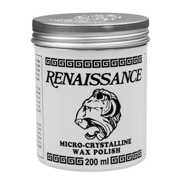

Some leather conditioners will corrode steel and although I consider Obenaufs the very best for conditioning and water proofing boots I wouldn't use it on a leather knife sheath. This is good stuff:
