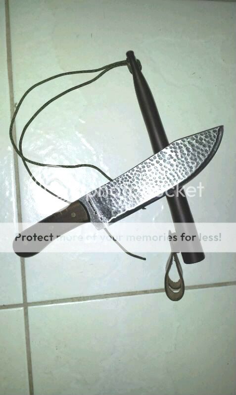

When my hudson bay arrived i was prepared, tho it came sharper than the boom. Took it to the belt and sandpaper too, I actually enjoyed messing with it as i filed notches on the slabs and gave them a rundown from 150 to 1000 grit, then finish with furniture wax, so now it's smooth and kinda grippy:
had to make a thicker leather washer and secure with a chicago screw after i snapped the swivel rivet
but yeah, it seems condors need an extra touch-up. Just got a kukri and might be fine tuning that edge some time this week, but i enjoy this ;)
