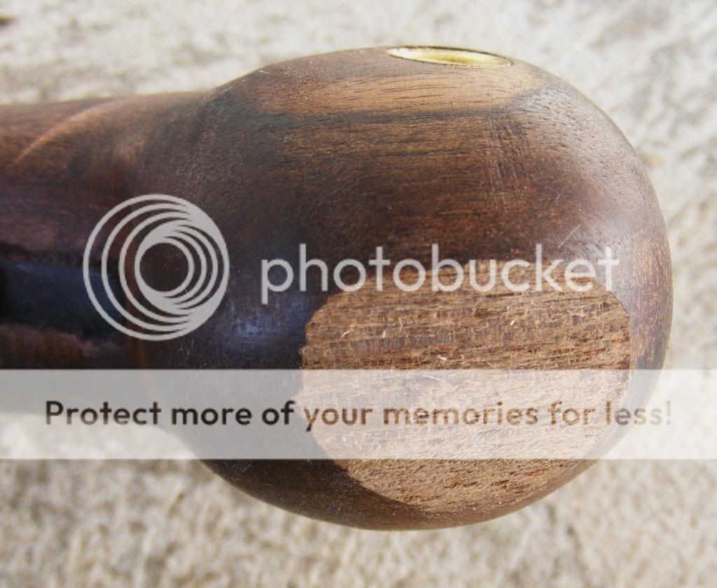

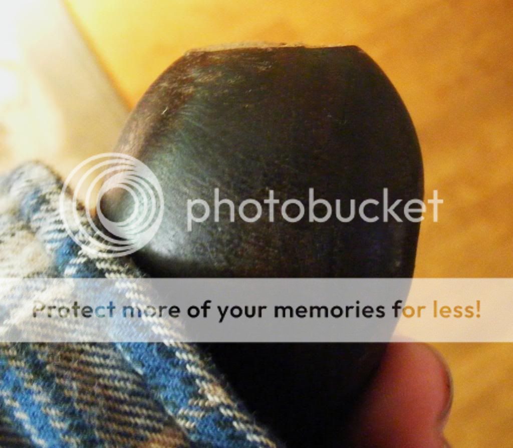

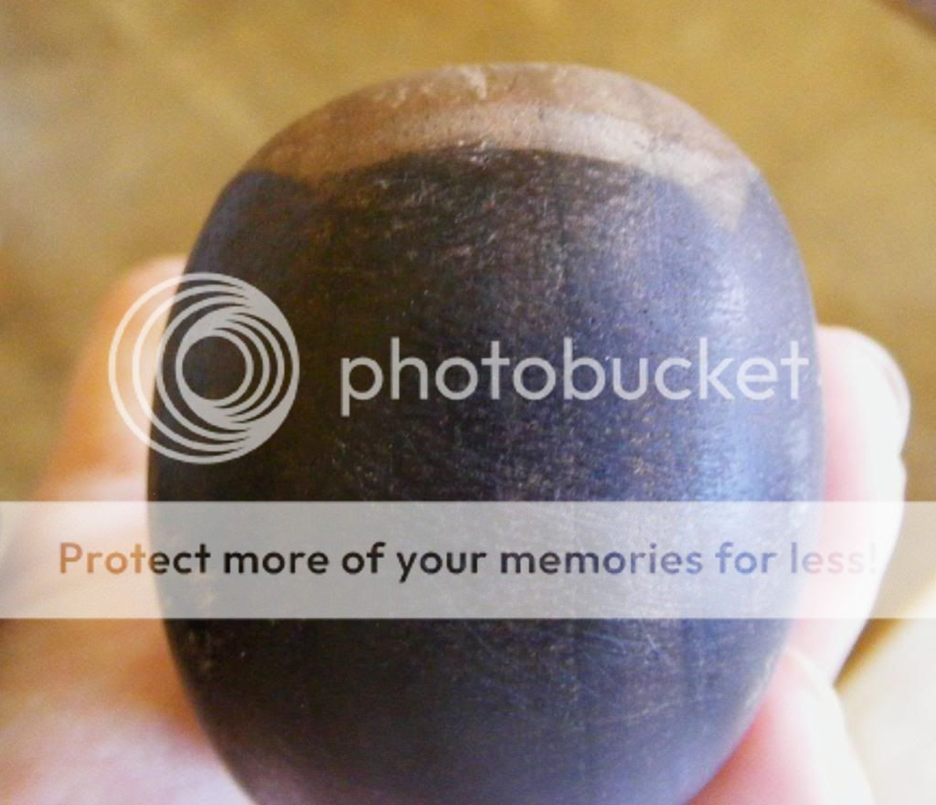

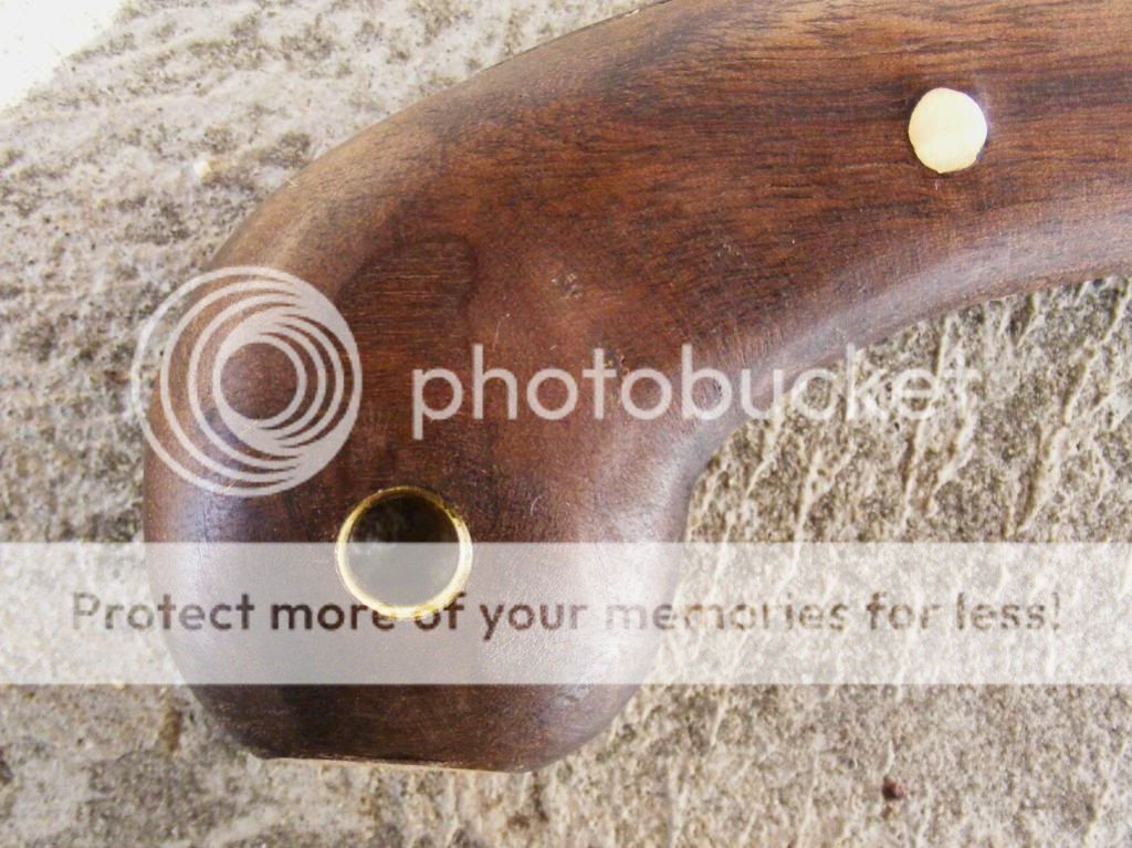

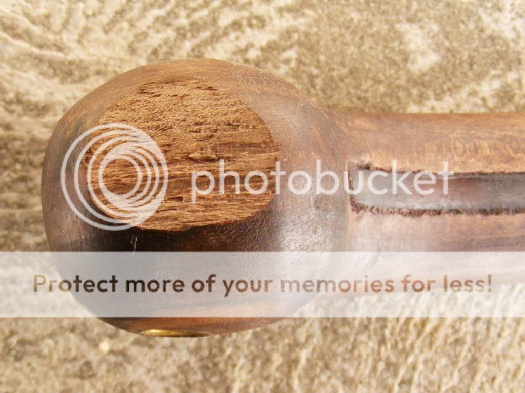

First, and most obvious, is the handle. There's a piece of the pommel missing, like somebody dropped it on the ground.
It wasn't even sanded down, almost like a person at the factory said "Yeah, that's good enough, throw it in the box".

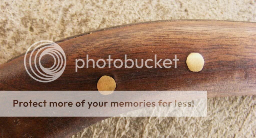

The tang of the blade also sticks up over the handle; definitely not flush.
In all honesty, it's not that noticeable, but everybody who handled mine felt it right away. The pommel can be sanded (and I will) and the tang problem can be fixed by wearing gloves or just not squeezing the handle, but this isn't how a knife should come from the factory.

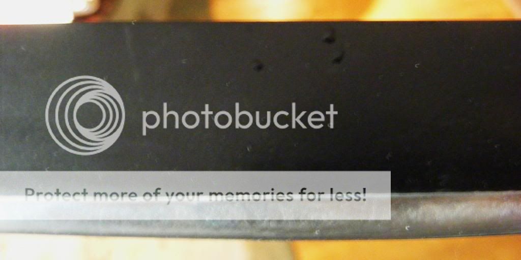

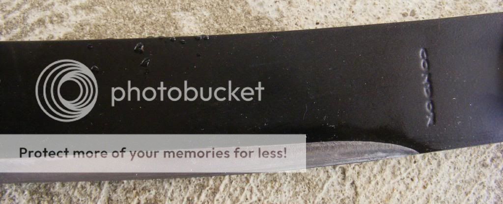

The blade also has this stuff on it...
That's not water or soda; it looks like some of the baked-on black coating bubbled up. It sanded right off (it was only in this one spot) and there was still black coating underneath it. I got all of it off except three small spots...

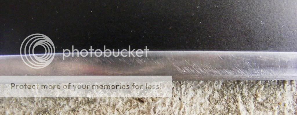

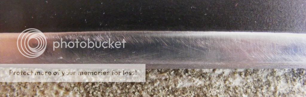

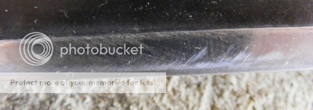

My last complaint is the edge itself. A lot of people have commented on how Condor's edges are razor sharp right out of the box. Well, mine was dull. The last 4" (towards the tip) was sharp enough to slice paper, but the rest of the edge was very dull and required a belt sander to get a decent edge on.

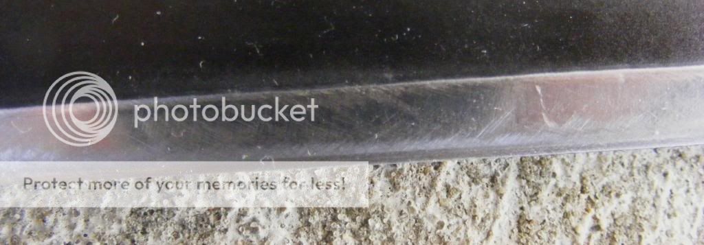

Also, the edge wasn't "perfectly polished" as many have mentioned, but it had visible grind marks. The photos below are before I did any sharpening, as it came out of the box.
The grinding goes in both directions, as if a stone or belt sander was used from two different angles...
Again, I didn't get this knife used; this is how it came right out of the factory box. There was a sticker attached to the box with some initials and date in check-off fashion, which I assume is the Quality Control information, but a QC sticker doesn't matter much if the product itself came with this many flaws.

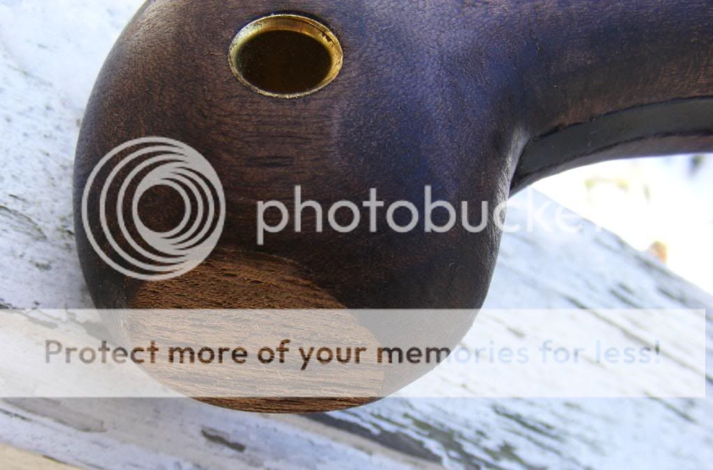

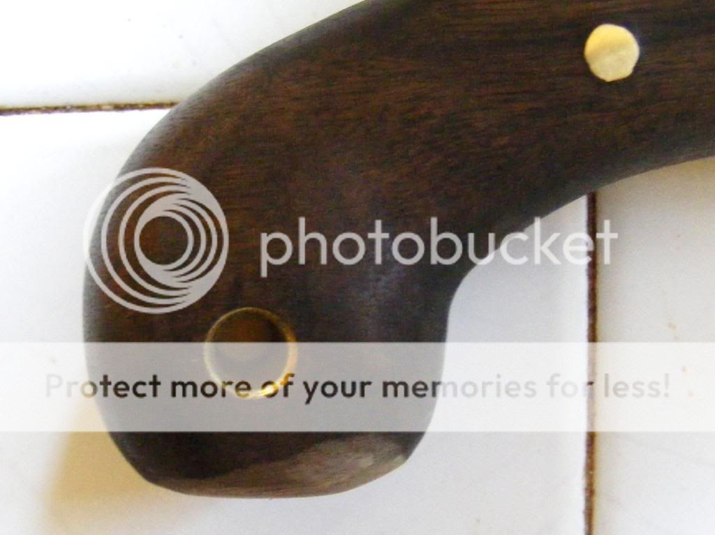

I've sanded the pommel to be more uniform (will post photos in this thread) and sharpened the blade up, but overall I'm disappointed. I know there will be follow-up posts like "You got a bad one; this isn't Condor's typical quality" and that's okay. I know Condor puts out a good product. I just didn't get one.
However, I still like the Golok. It's a good design and fits my hand perfectly.

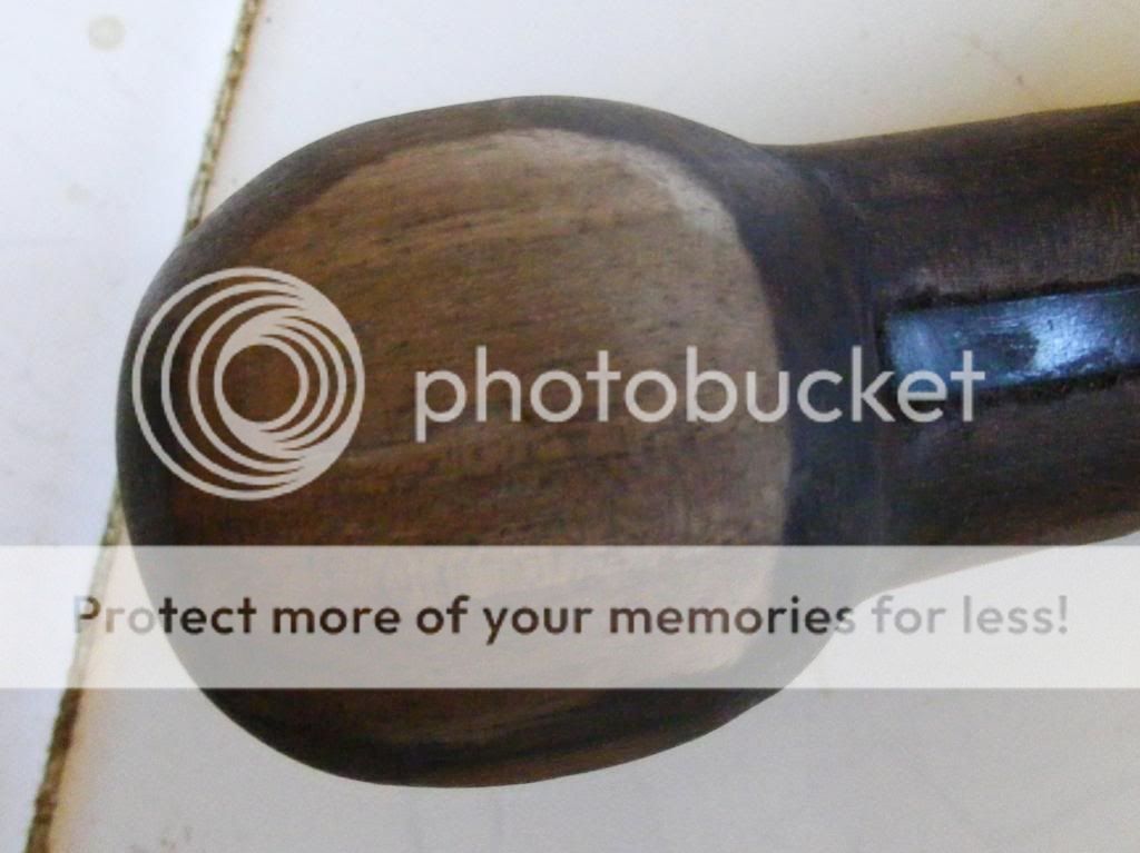

I sanded the pommel to be more uniform, but haven't stained it yet...

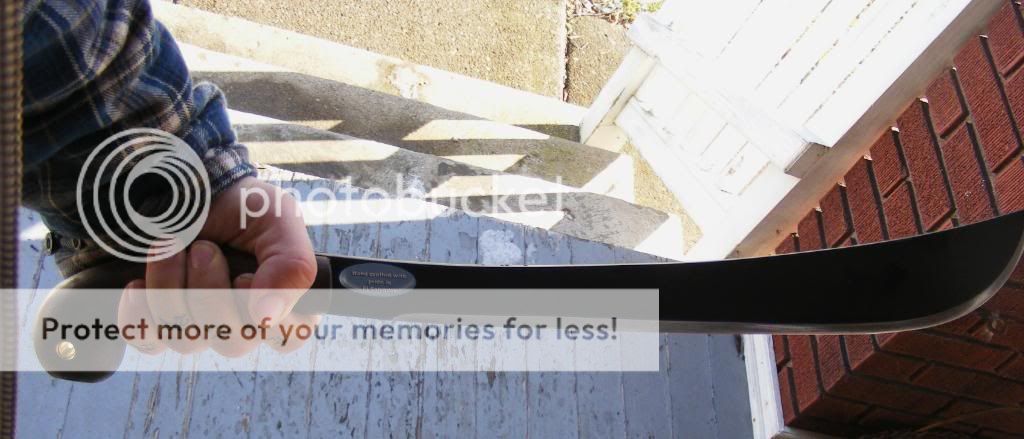

I'll say it again; it's a very good fit in my hand...
Wow, that pommel is horrible! I would have sent that knife back! A knife with that much wood missing should never have passed QC.

The bend was fixed with a vise and gentle pressure. I'm sure the spots will go away with use.

It didn't take long to fix: about five minutes of sanding the pommel, 25 minutes of sharpening, two or three minutes of constant (and slow) re-bending, and perhaps ten minutes of sanding the rust and spots off. I guess I'm mostly disappointed in the fact that I waited for almost three months for these to become available, another two to actually acquire one, and then I get one that should have failed Quality Control.

The blade tapers from 1/4" thick at the handle to 1/8" thick at the tip, if that's what you mean. The grind itself is just a tad wider toward the handle, and slims out a tiny bit near the tip.
