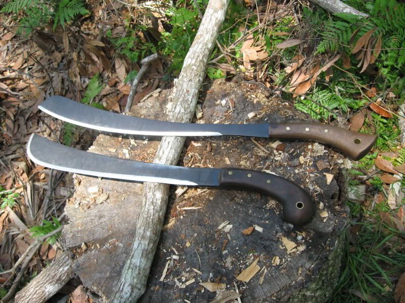

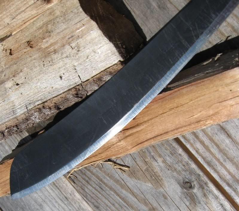

After touching up the edge, I took the Condor Parang out back for a little workout. I brought my Condor Golok along for a comparison. The main difference is the length. The longer 17.5" blade of the Parang gives it more reach and an advantage in slashing brush. Both weigh about 21 oz, but the stouter feeling golok has a 14.5" blade. Mine is an early golok from last year's Blade Show. The handle is a little blocky, but I thought it was fine until I held the Parang. I love the feel of the handle on the parang. Both have a distal taper from 1/4" at the handle to about 1/8" thick at the tip.

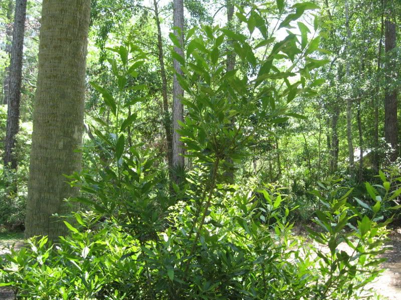

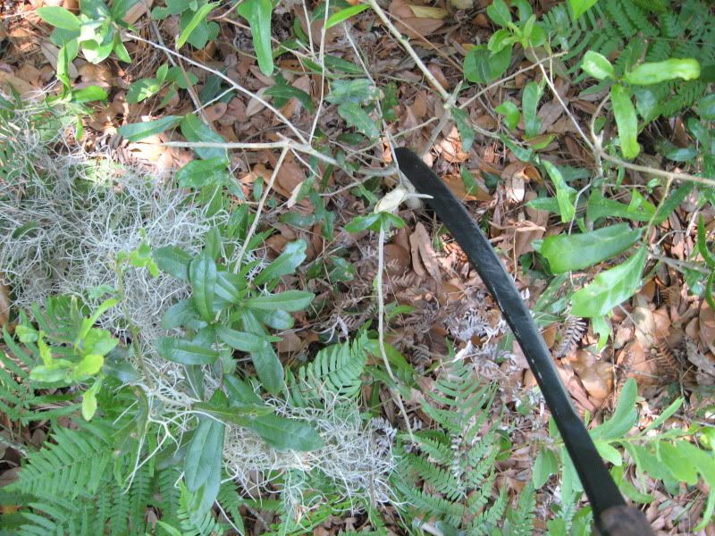

These fibrous, tough, woody live oak suckers are always a challenge for any machete. The parang cut these well as long as I hit them at an angle and not straight on.

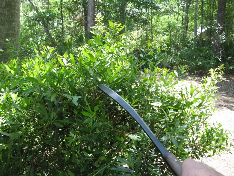

On the less tough Wax Myrtles, the parang did a fine job of trimming them up, even hitting them straight on like trimming a hedge.

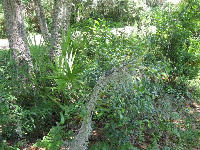

My favorite knife for trimming my Wax Myrtles back has been my Bark River Golok, but the added reach of the Condor Parang is appreciated here.

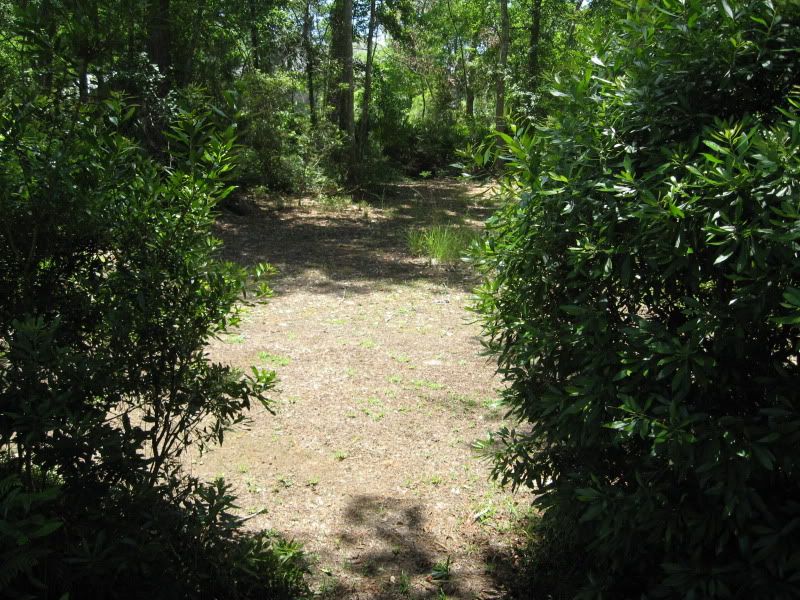

There, that's better. With a good edge, the parang is a great hedge trimmer!

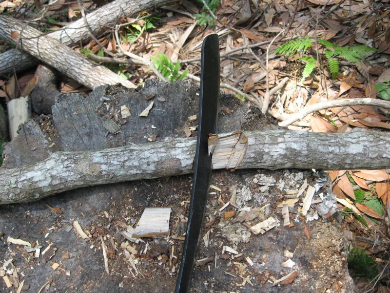

With 17.5" of blade, you can get some speed on it. That helps in chopping, too. It only took six chops to go through this hard dry wood.
This handle is really comfortable to chop with.

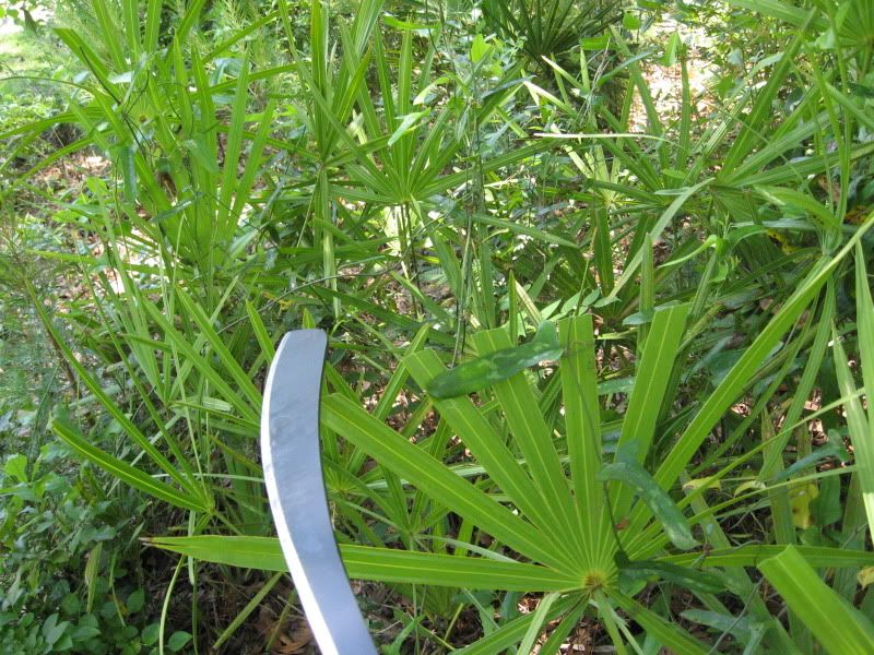

The parang easily slashed through tough palmetto stalks, and even slashed standing palmetto leaves clean. You need a good edge to do that.

The Parang goes out to Chapman today. Careful, it's very sharp now. :D I kept it until after Blade. While I had the time, I put a new edge on it.

I have not had the chance to handle a Condor or any other Parang. This thing has a seriously thick handle. It flairs like the bottom of a large ax handle at the butt. The Parang seems to have traveled pretty well but the tip rolled. The edge is really nice, so thank you Horn Dog. Did you hand sharpen on a mousepad and sand paper?

The tip rolled? Man, I had that blade well packed with taped up heavy cardboard. Never under estimate USPS. I used my Kalamazoo Belt sander and finished the edge with a 9 micron belt.
