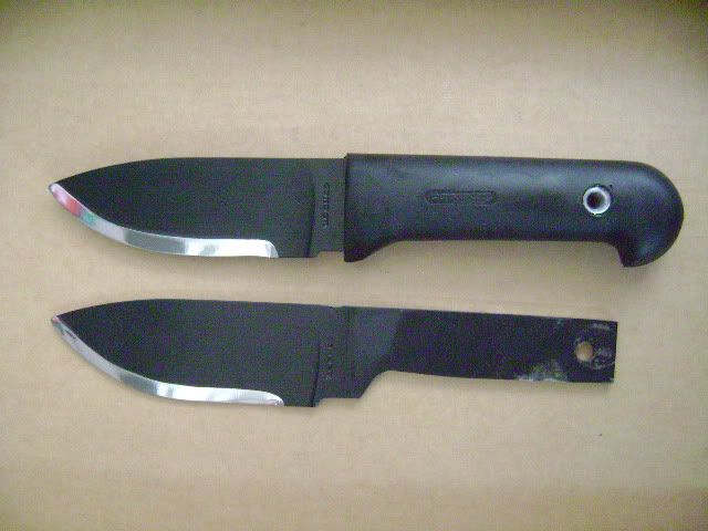

I have a Rodan and I am not sure what to make of it. I do admit that it is growing on me.
It is sturdy and well made. I have yet to get it razor sharp but I can put a pretty good edge on it. I don't think it would be a problem for someone who is good at sharpening.
Both my rodan and nessmuk are a bitch to sharpen. I may not be doing it right but all of my other knives take and hold edges much easier. The nessmuk chipped alot while the rodan has not at all. I do prefer the rodan alot more. It is a good knife for the cost and I have batoned easily with it, even with my sharpening issues.
Hey there tsacain, if you had chips on your edge, then something was wrong. If you want a new one let me know. I'm pretty surprised to hear so many are having a rough time sharpening them! They have a convex edge so you may want to try rough sand paper first and then move down the line on it. If you don't like that type of edge, don't be afraid to take a file (seriously) and put a secondary bevel on the convex part. That may make it easier for field use. Thanks for all the input!
