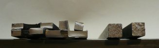

I finally built a PID-controlled oven after using a forge for HT'g. I work with 1075 and W-1; I quench in Parks #50.
The forge was too small and too un-even to be ideal, but I took my time and made it work.
I was aware that my grain size was on the large size (from seeing broken throwers), and I'm aware that the main cause of this is over-heating. However, I thought my heat-treat process was under control for the most part.
The first time I used the oven, I was thrown off base.
I initially placed the thermocouple relatively close to the heating elements. Most of the weird things I observed (such as 20° swings in temperature, and blades that were still magnetic after 20 mins at "1480°") ceased after I finally moved the thermocouple to the door, away from the elements.
Besides that, I observed that the steel was what I would call a subdued red, and barely non-magnetic (after 20 mins in a pre-heated 1480° oven). With the forge, I quenched when the steel was a self-luminous bright red; completely non-magnetic.
I also noticed that the quenching was much less violent with the oven than the forge.
Now, I've pretty much concluded that I was simply over-heating the steel in the forge. However, at the time, I suspected that the PID or something else was faulty, so I utilized the two basic tests that were immediately available.
I HT'd some bad blanks and bar (no tempering), broke them to examine the grain, and did the dubious file-skating test.
My standard practice is to remove the steel from the quenchant at 10 to 12 seconds to straighten. Then I let them air cool. I use the flash-point of the oil to estimate 400° or so... my infrared thermometer said it was closer to 300° but it is not a reliable thermometer.
So I did the same thing with the test pieces. I'm not sure if this has a significant tempering effect; nor am I sure if the technique has a "name".
I observed that the W-1 would skate the file 100%, and it would snap cleanly when clamped down and smacked with a hammer.
However, I observed that the 1075 would skate a file to some extent, but not 100%. Also, it would not snap cleanly. It would bend approx 10°, then snap. I confirmed this with several blanks, stopping when my 3-lb hammer blows ripped out the bolts that mount my vise to the wooden workbench.
I really thought that the 1075, despite the lower carbon-content, would snap cleanly and skate a file, without a temper.
The grain looked desirable (as far as I can tell). I am aware that the file test simply tells me if the steel's surface is harder/softer than the file itself.
The pic shows broken oven items on the left; a forge item on the right.

milky looking grain is what you would be after
you should see CPM steel when its jsut right
if you have an HSS mil bits that are shot brake one of them and see how it looks

Patrick, just a little tidbit, FYI. The file test does NOT tell you that the steel is harder, or as hard as a file. A common mill file will not cut steel over 58/59 Rc. It skates beyond that hardness. If you get the opportunity, try the file test on a blade that you know is around 60/61Rc , and you will find this true. Most of us do not have any better method to test the hardness out of quench, but be aware that is as accurate as a common file gets.
Pat, you're on the right track!
Was a big eye opener years ago when I discovered I was overheating blades in the forge.

Anybody who gets really obsessive/compulsive about this whole metallurgy thing will eventually need to have a look inside of their steel and see the microstructures that they are always reading about and pursuing. Martensite is hard and will skate a file, but the same is true of very fine pearlite, or Bainite, loaded with carbides, the Hardness tester can’t tell you the grain size that is just as important for performance.
There's also the infamous decarb that won't skate a file but you may still have a hard blade underneath.
