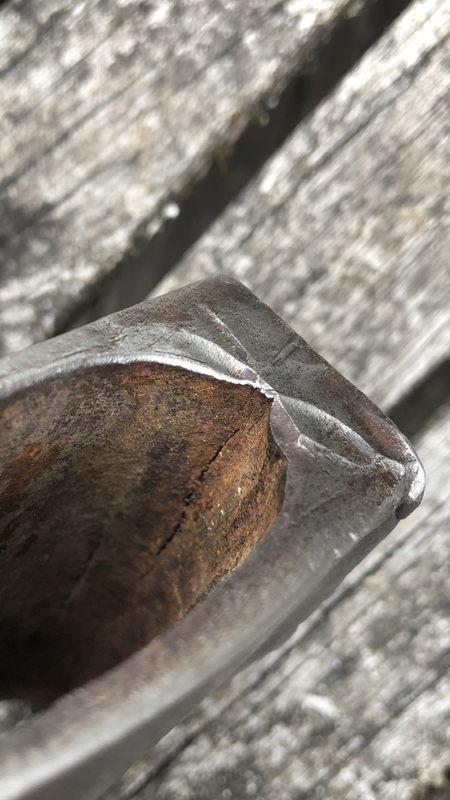

So, finding a Connecticut pattern axe in my neck of the woods was a surprise and a bit of an oddity.
It’s a 4lbs 1oz AmericanaX

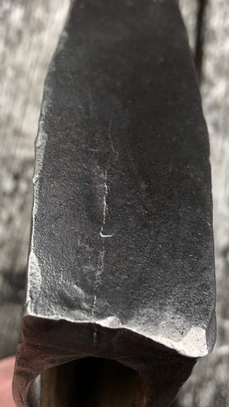

My problem was realized last night when I was cleaning it up and all the rust was pulled off poll:
I know that polls can be ground out and repaired but I lack the equipment as much as the experience.
I guess I’m looking for someone here to hire/trade to fix it properly for me.

Definitely worth fixing though! I have seen that same crack in several of my axes too. It wasn't anywhere near to wearing through though. So I think in my case instead of being cracks they are incomplete welds. I hope you guys can convince him to fix them all!!

Agent_H,i find it curious that practically everyone else's axe is cracked at the front or side of eye, where the thinnest part of a head is.
The poll of your C. does not appear too beat-up either...It's possible that a fairly major mushrooming was cut off,but distortion of any critical degree is not really apparent(in photos at least).
I've seen a couple axes that were literally beaten to death,and they both failed at the thinnest section of the cheeks,never through the center of poll,and not without any visible distortion of those thinner sections either...
All this plus the looks of it,plus a gut feeling,make me want to say that that crack happened when that head was forged...

Again,a gut feeling more than any solid knowledge,but that crack to me looks more like a result of forging rather than abuse in later life of tool.
It's a possibility that this tool has actually hung together in this wise since it was forged...That crack begins and is wider on the inside of eye and was overlooked or neglected;on the outside was initially filled with paint then dirt/rust,or was not visible and became so only with later clean-up Or propagated,however slowly...
(all my jabber above is a waste of time as it still needs fixing:)...I'm not a welder and could not do this without inclusions myself.But it wouldn't be too terrible of a challenge to a pro;i'd make a cut with an abrasive disc clear through the poll and do so in a V-config.;it'd save on much tedious grinding and should only take a few minutes).

To run ahead slightly,two things may be pertinent:
1.At close personal examination i tend to conclude that the eye on this axe was obtained by slitting(& subsequently drifting to shape).
The slitter being ovoid in section normally has it's edges(ends of oval section)sharp.Those leave a little pointed dimple on the aft,poll, end of the future eye especially,as the steel is elastic only to a point.
That little groove down the inside of the poll has served as a stress-"riser"-concentrator-when some dips..t sledged the poll sufficiently to propagate a crack starting at the dimple and running the entire thickness of poll.
Steel is a crystalline structure and very succeptable to such dynamics(somewhat like glass being scored for breaking along the score-mark).
2.In spite of my agreeing to do this i chickened out at the last moment and went to my buddy Andrew,a professional welder.So i only am doing the grinding and other dirty/dumb tasks,while he directs the process.Andrew is super experienced and competent(with strong anal-retentive component)and i trust him implicitly.And this is such a classy old axe,et c.
So,he had me grind it thus:https://imgur.com/g83sC9b
That V does not go clear into the eye,to avoid any possible distortion of halves relative each other.
It'll not be a 100% integral,thickness-wise,but we sacrifice that as there'll be plenty of reserve in repair to do it's two main jobs;to keep the poll in a circumference holding in the haft,and having the proper amount of mass for the balance et c. of this tool.
