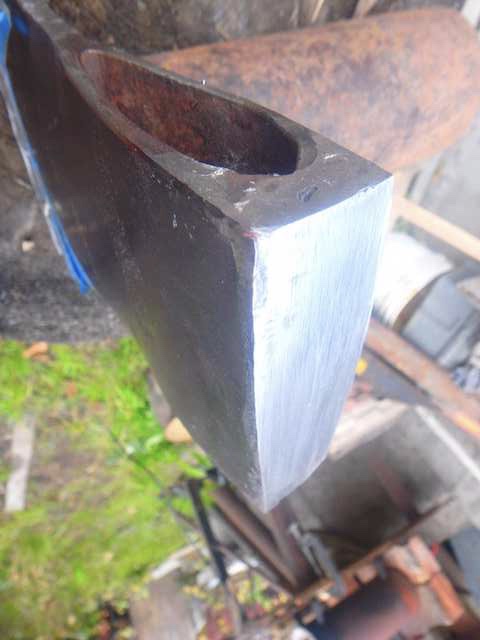

Arright...the madness of my reality having temporarily moderated i finally had a chance to get back to our CT...
I'm more than ever impressed with Andrew's competence,that weld had no voids whatsoever,nor was there any erosion along it's edges that i feared.
That surface ground entirely solid and level,and Just to the level of original material(naturally i'm absolutely reluctant to take it down in Any way past that).
https://imgur.com/wF6eshP
I've had lesser luck with planishing down the edges of that mushroom.
The material is dead-soft(originally or after repeated heating during welding we'll never know).
In theory i could've planished it in perfect plane with the sides of eye,but it seemed like a Lot of mass to be moving cold,and the inevitable resulting dislocations to the lattice is not what we want in a working tool.And i really have NO earthly idea of where the limit-the critical embrittlement-would be with this particular alloy.
Again,i felt right doing only the absolute Minimum of invasive processes,i'll let our esteemed Agent_H make any decisions in regards to further modification of the shape,according to his tastes and instincts...(i'd chamfer those sharp edges at least a little,in some manner,rounded or faceted...).
I feel that my part in this was repair only,and i believe it went as well as could have been hoped for...
Personally,i enjoyed this greatly.I think that there's a tremendous potential in old axes+fabrication principle...We all touched several times on assorted repair and even re-blading issues,and this small episode reconfirms my confidence in a great potential in this direction...
I'll shoot this back to the rightful owner as soon as our PO opens on Monday,and hopefully he'll get it soon,and maybe give us the benefit of his thoughts on all this once he looks at it closely...
