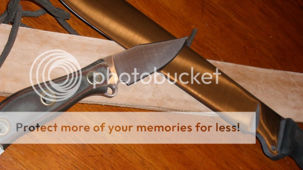

And it dimples depends on that kind of knife it is, a B-11 shouldn't have any dimples, my NMSFNO didn't
But here's my FFBM, she's got a lot of dimples, but that's a saber grind issue from what I've seen
I've noticed on my FFBM that I get surface rust on the skull crusher but a little mineral oil prevents that. Stripped blades clean up a lot easier too and they cut better.
Stripped B-11's look sweet by the way :D

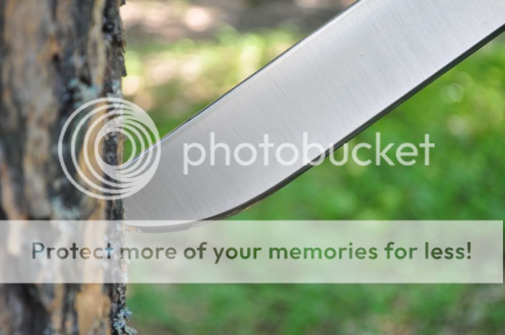

I stripped my Basic 11, I think it came out decent. Chemical stripper and 1x42 belt sander used.
Before -
After ghetto satin -

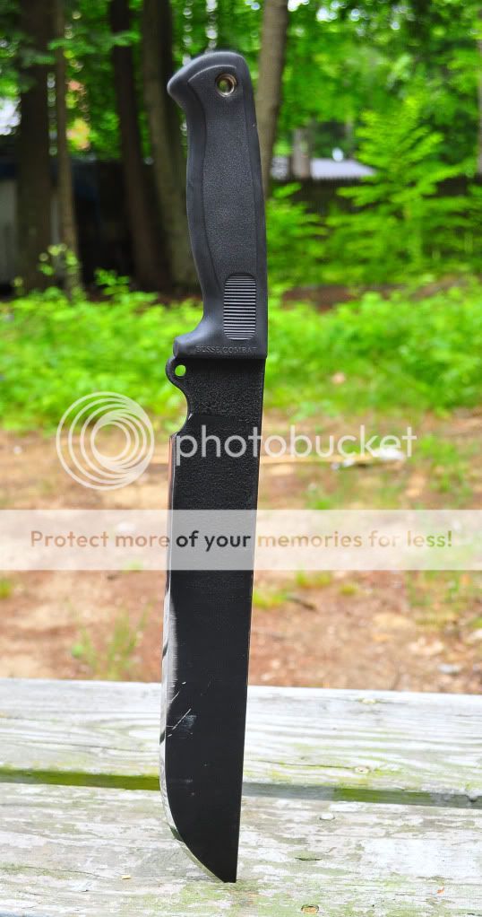

5) even during the most abusive tasks, satin doesn't look *that* bad, unlike coated knives which look like someone took a hammer to your cars paint job.
