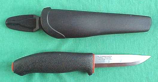

I have nothing against good, cheap knives like the Mora clippers.
Let's say up to $60 for a nice knife, and up to $150 for a really fantastic one. Let me know why you think the knife is fantastic. (Or at least nicer than a Mora clipper.) Will it feel better? Cut better? Last longer?

Here on Vancouver Island red cedar is usually the dominant driftwood and is in pieces of all sizes . A small axe say 1 1/2 lb and 17" length is my favorite size but really you don't anything above a Mora knife to get a fire going. I might carry a folder but the stainless Mora is the knife that will get used .

Now I have discovered Moras. I think any of the stainless blades would serve you well. Swak, Clipper, or M2K would be my choice now. Light weight, easy to sharpen, hold up well, and are dirt cheap. Water doesn't bother them much. I would look into Eric's (Normarks) shealths for any of these, I just got two and they are great. They secure the knife alot better than the orginals.
If I had to pick from the above, It would be a Stainless Clipper in Eric shealth. The shape lends itself better for cleaning fish and it get scary sharp.

Might have to pick up a Mora since everyone keeps yammering about them.
