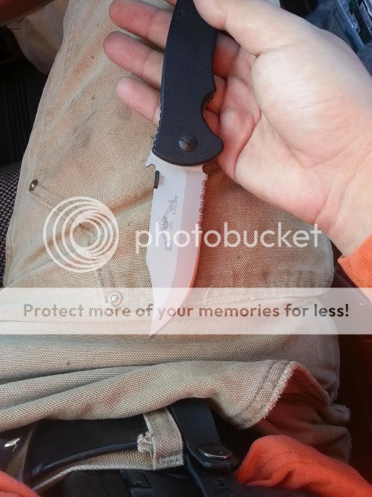

I believe GPK or New Graham will have the satin in stock. And I'm a roofer. My 13 rides in my tool pocket in my work pants and I've never had a problem with mine opening up on me in my pocket.

Neither of my Emersons opens unless I want them to. You're safe with the detent on the 13- I've hiked, hunted and backpacked with mine just fine...
