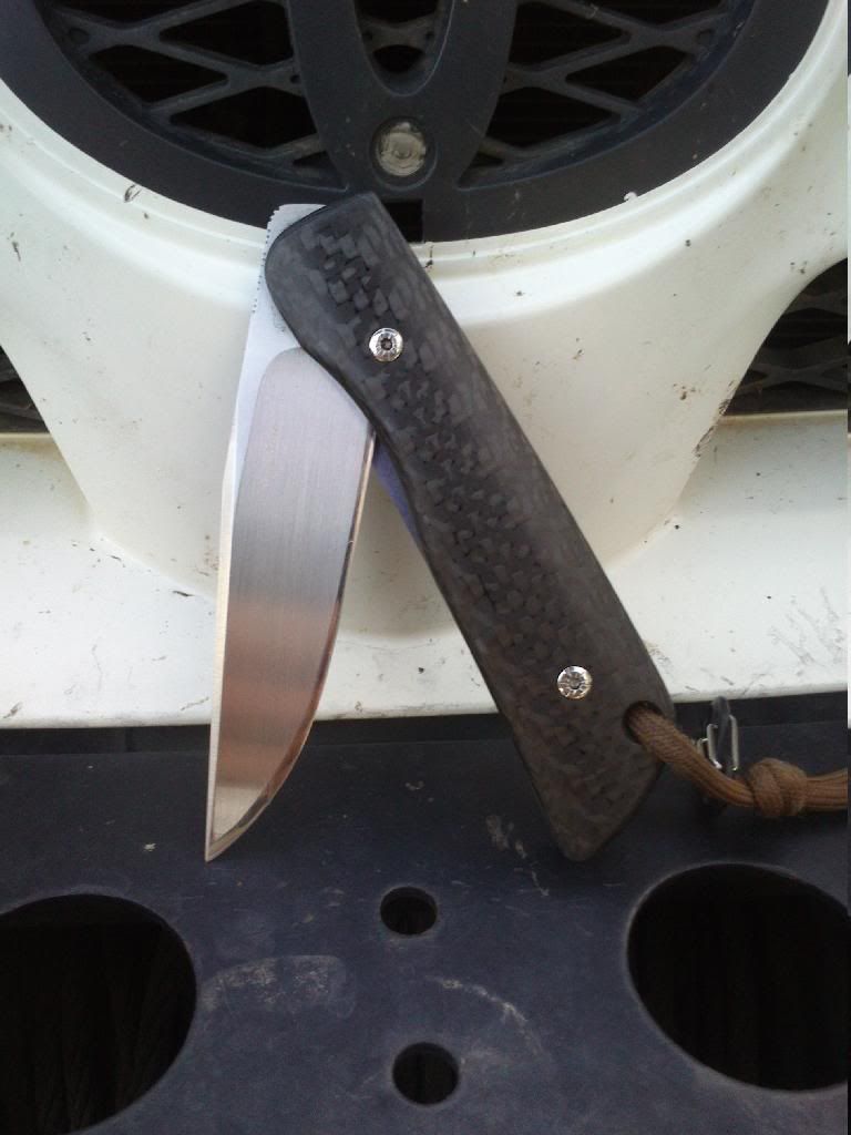

consistent angle extreme sharpness
5DPS on CPM-M4
Around 8DPS Para 2
5-6DPS Nitrobe 77 (not the best picture)
That's looks amazing. What did you use to achieve that angle?
Wicket edge plus tormek small knife jig and the extended rods. But... S30V at that angle will not hold, you can see the chip near the tip... that's from cutting a zip tie. I will soon be giving her 15 dps micro to get that chip out, it may form a visible 3rd bevel instead of micro bevel.

I finally gave up. Even though my knives can easily cut wire ties I chip my ZDP-189 even at factory grinds, ooomph, ooomph, oomph. I've decided shallow angles and my ZDP-189 are must haves so something had to go :
cutting of wire ties with some of my knives . . . well all of them . . . except for :
Super thin AND shallow ground SAK. He never EVER chips with shallow. Go figure.

get a granite tile from the home center and use some double back thin tape or spray mount adhesive to glue a section of one or more of these NORTON belt sander belts (also can be had at the home center) onto the tile. These suckers are unbelievably aggressive. Yes you will need to do it by eye and hand but that is fun right ? You can finesse it on an Edge Pro (you have one on order right ?) once you get the excess metal out of the way on these belts.
Zirconia Alumina
Oh Yah Baby !
thank you, that is exactly what I needed, I just finished reprofiling a paring knife at approx. 10 dps. It worked much faster than what I had been doing, and those belts are incredibly aggressive, you weren't joking.
