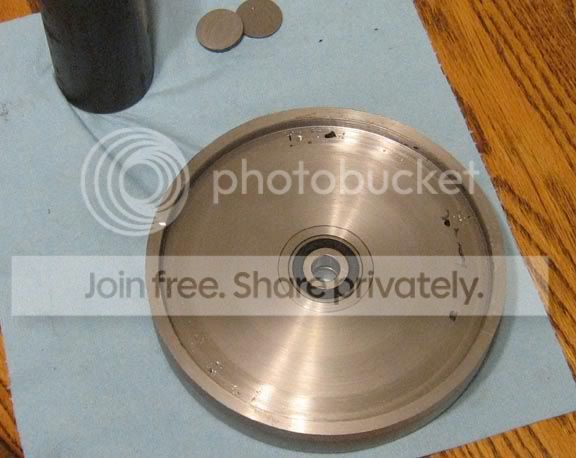

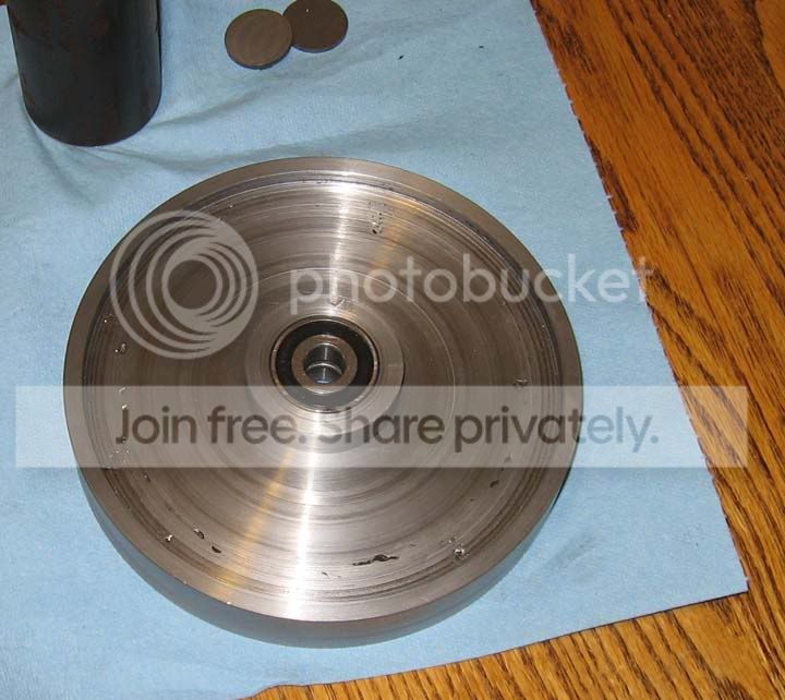

Finaly found some time to do some work on my wheel, I had some serious under cutting going on with the welder that day I was welding to much gap, so it didn't clean up as well as I would have liked but it will work.
If I found a 2x8" wheel with an 80 durometer surface would that work? It's under $50 comes with 1/2" bearings and available through a local supplier.
John, that wheel is great. All you need now is someone to put a rubber tire on it, about 60 to 80 durometer and 3/4" thick to give you room to re-dress the wheel a couple of times.
