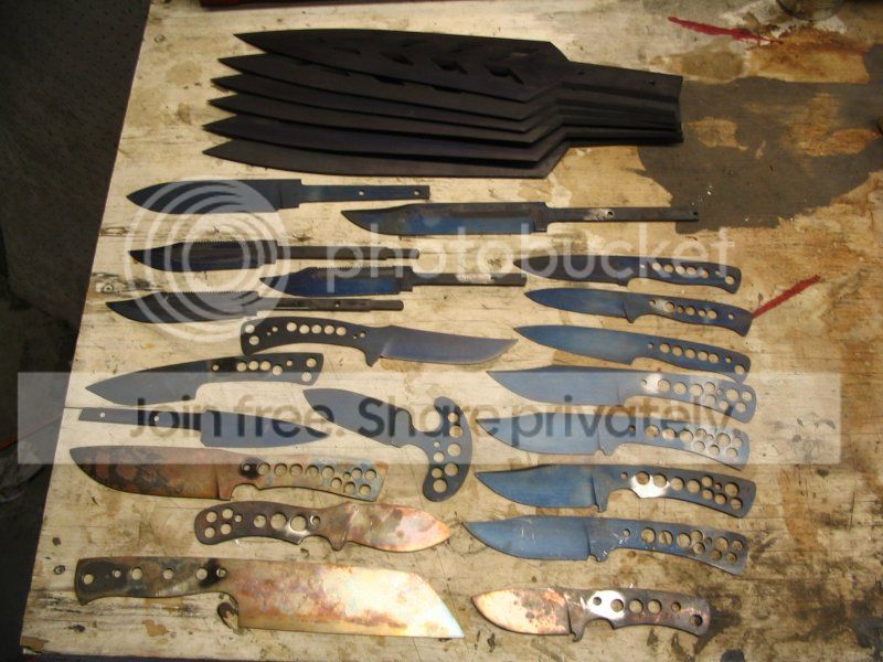

My batches come back from Peters with pretty uniform color. I'll dig up a pic if you like... it's not very exciting.

The blue/black blades are oil-hardened steels (O1 and 1095), the bronze ones are air-quenched (CPM-3V, Elmax and CPM-154).
OMG, is that a stack of SPEARS??
Thanks for the pic, JT.
-Daizee

You're welcome. Told you it wasn't very exciting, lol. Well, except for the spear-heads. :p
Did you get the order for all 300 or are you just sub-contracting for that half-dozen there? :D
