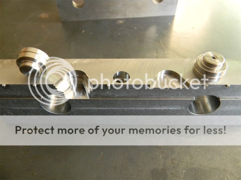

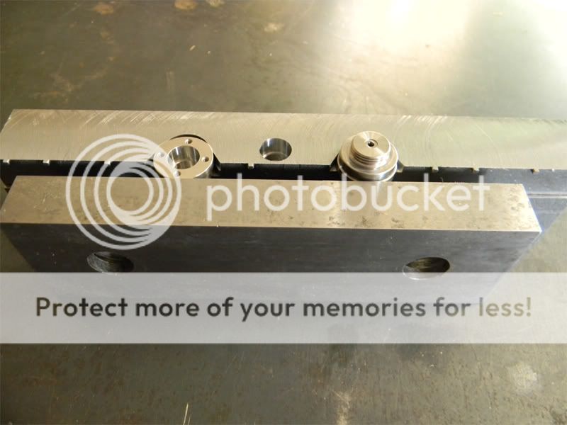

This is a steel soft jaw fixture that has been reused for a couple different parts. Two things to take note of. One, I often like to bore a hole in the fixture to pick it up with a coax, for me it is easier, faster and more accurate if I want to put it back on in the future. And notice that I'm gripping round parts but I didn't make my pockets round. I like three contact lines. A round pocket will only make good contact if both the part and the pocket are exactly the same unless you really crank down on it and get significant elastic yielding. Otherwise a larger pocket will only contact in two lines, and a smaller pocket will contact in four places in an uncontrolled manner. On a part like this, either can lead to rocking. So for something like this, I like three planes, 120 deg apart, one of which is just a regular hard jaw.
These jaws are steel. I always use aluminum if I can get away with it, but aluminum wasn't going to work for this part.

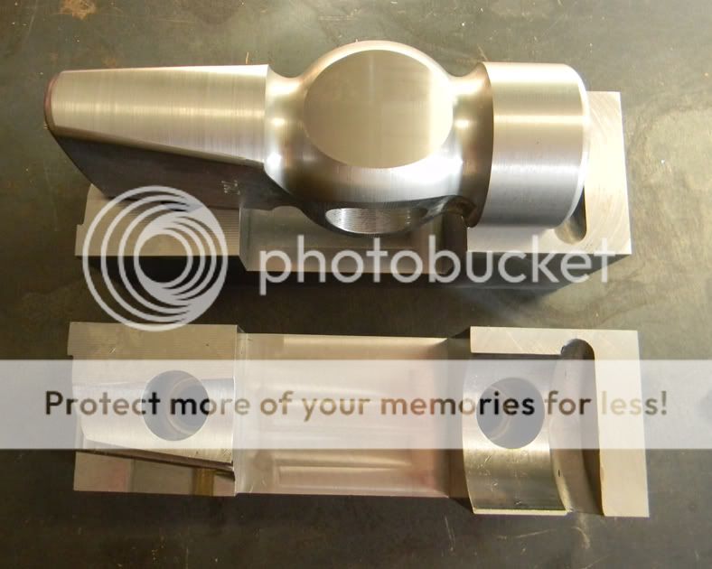

This is a variation of the same thing, steel jaws to hold Tai's hammers. There are some heavy cuts in 4150, so this fixture is steel and beefy, while allowing access to the surfaces to be cut.

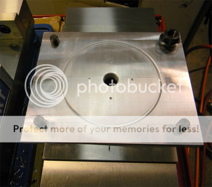

A very popular and easy to make a fixture. Drill and tap holes around the perimeter of your part. I thread the screws in from the back side, and hold the part down with nuts. Most folks just run the screws in from the top, but doing it from the back, the threaded posts are rigid so they don't rock away from the part as you tighten up. You get a better grip and the part stays flatter.

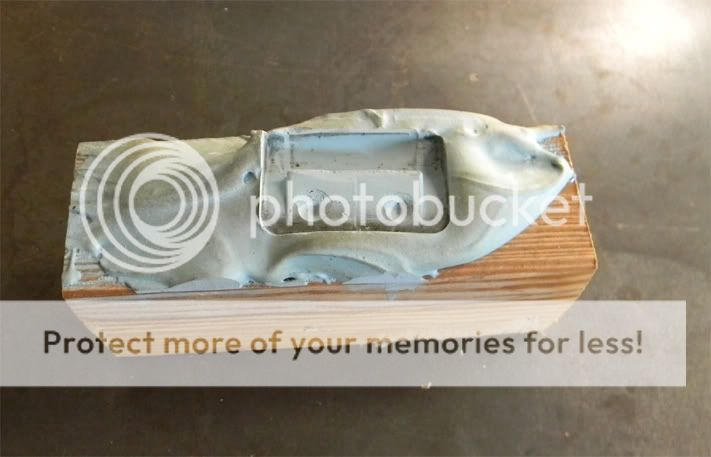

And last but not least, the humble bondo fixture.
This is a great easy fast way to hold onto odd shapes. This one was used to countersink some holes an off-the-shelf spring hinge. I probably ran 100 parts through this fixture and it was still locating accurately.

Bondo is sweet manna from heaven. Perfect reproduction, dirt cheep, ready to use right now. However, it isn't always strong enough for real work, it stinks up the shop, and even though it can position a part with good repeatability, you still have to orient the part accurately. It is not always suitable for contact with certain parts of a knife like the handle because of the solvents. For this reason, the epoxy puddy Tai is talking about is probably better for knife work.
You all might want to take a look at polycaprolactone. This is a polymer that feels a lot like one of the more rubbery nylons. It melts around 160 deg F, and because of relatively low thermal conductivity can be safely handled and molded while at this temp. You can heat it up in hot water, or in your oven to melt it, then you can mold it around your part just like the epoxy puddy. Once it cools off you're ready to go. You can reheat it and use it again. It is non toxic (I think it is the same stuff used to make bioabsorbable stitches). I picked up a couple pounds of it sold as "Polymorph" on ebay for 20 or 40 bucks.
