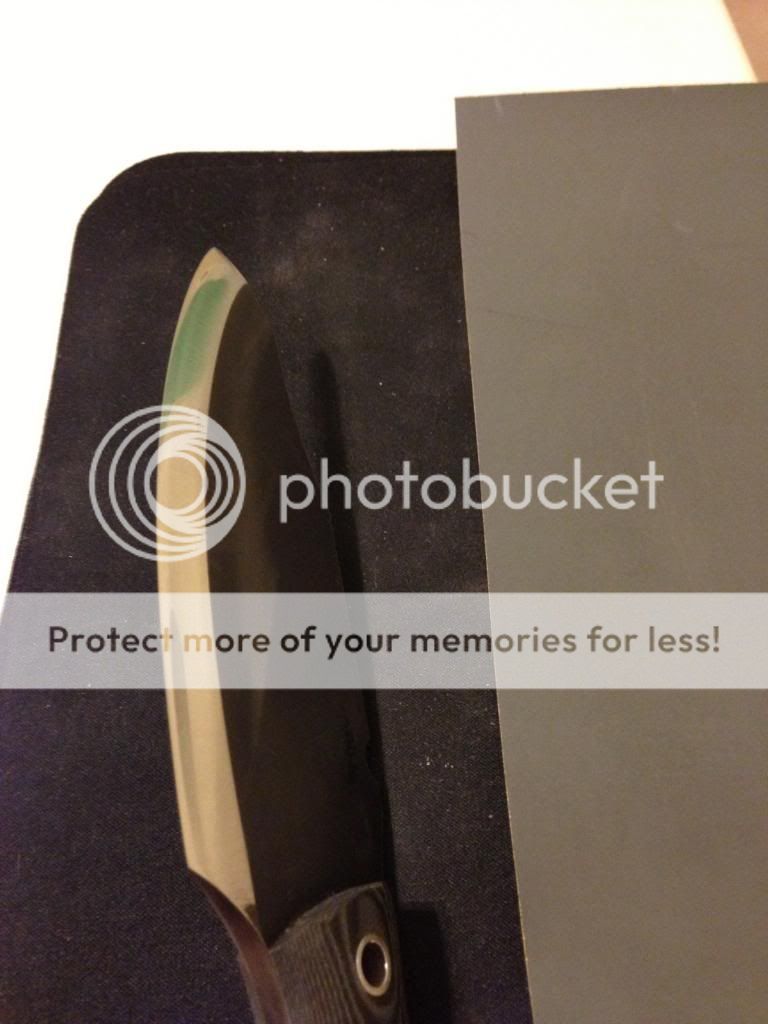

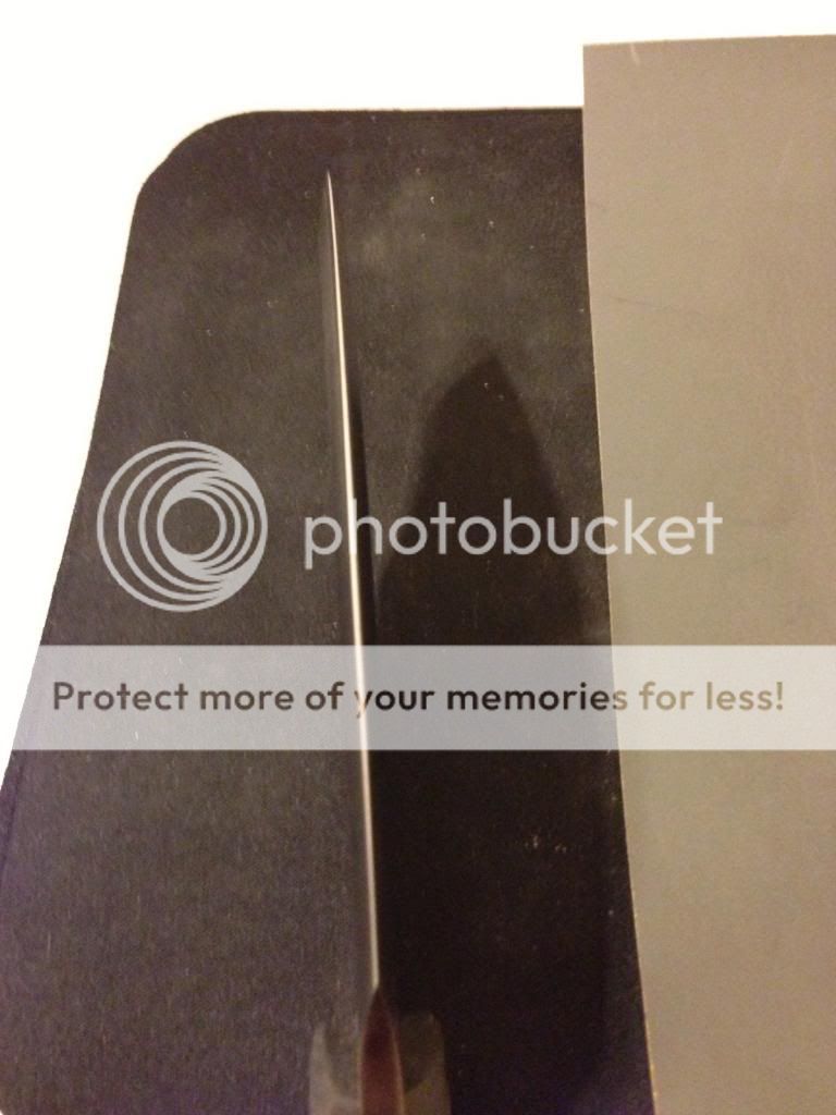

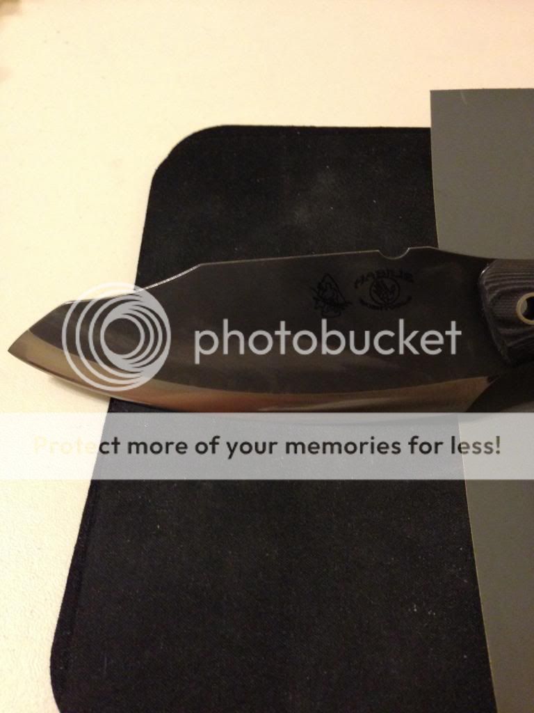

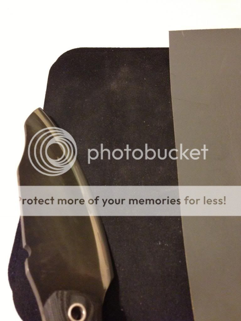

Since I already had a convex from the belt, it didn't take too long to put an edge back on. I gathered that you need to put some pressure on the blade to get the paper to bend around the blade edge slightly. So, I went with the angle I used on the belt, and seemed to work really well!! Started with 180 grit paper that I had laying around, then moved to 2000 for polishing. Hairs are flying off, and I had to use a broom to sweep up the paper on my carpet... Anywho!! Here is the end result:
Opinions?

...Since I already had a convex from the belt, it didn't take too long to put an edge back on. I gathered that you need to put some pressure on the blade to get the paper to bend around the blade edge slightly. So, I went with the angle I used on the belt, and seemed to work really well!! Started with 180 grit paper that I had laying around, then moved to 2000 for polishing. Hairs are flying off, and I had to use a broom to sweep up the paper on my carpet...
Opinions?
Well, this part right here caught my eye. That is not right at all. I made that mistake, and I was able to get my knife sharp in spite of that mistake but it will not get as sharp as it could if you continue to make that mistake. The reason is that as you sharpen on a material with give, if the sandpaper curls around the edge it will work against you by sanding the apex, which is what you do not want. That is where your edge is, so it is self-defeating to have anything sanding against that.
Looking at your pics, I think you would do better to lighten your pressure, and just increase the angle that you are holding the knife. Eventually you will reach a point where it sounds different, and you will definitely notice it if you are paying attention, and that is where you need to be. Convex is more art than science, but that right there can make things a lot easier for you. If that doesn't work, or maybe even before you try that, cover the edge with black sharpie, then run it across the paper a few times until you see that it is going all the way to the edge. You might need a magnifying glass to see it, but you need to make sure it is going completely to the edge. The only weight you need is the weight of the knife itself, and if you have to add pressure, you are doing something wrong (unless you are sanding off excess material instead of "sharpening"). Just my two cents, but I would try it and see how it works for you.
