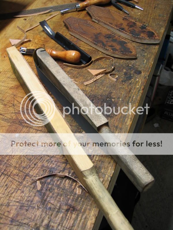

If it helps, you can think of it as intelligently "being sloppy" on your angles on a stone :) That doesn't translate to words well. strop bat, strop bat. make or get a strop bat.
+1:thumbup: If I were going to point at the one thing that has taken my edges up a notch, this would be it. I just use two sides, one with white polishing rouge, and one with Flitz. Maybe 3 minutes to polish up an edge, remove any remnants of a wire edge, and flat out make a good edge a great edge;)

I take it you mean a strop attached to a solid backing, instead of a loose strop? If so I have one with green Lee Valley compound and plain finished leather on the other side. Thank you.
pretty much, yeah. I've got a few I've made, I'm considering ordering one of the JRE ones to see how his leather prep is, though.
These are a couple of my "go to" tools when making bevels and sharpening. The one in the foreground is your basic strop bat and the other one is a backing paddle for use with papers or emery cloth. I clamp the blade to the edge of my bench and use it like a file.
Rick
The backcut holds the far end of the paper in place while your index finger grips the loose end.
Those are awesome Rick.

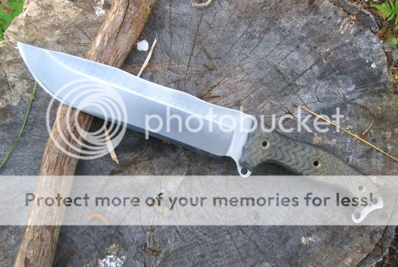

This one is hard to describe! it's not a saber grind, not a full convex, and not a scandi.
QUOTE]
yeah, that is basically the older "condor" edge too. Basically, a hard edge to describe.
wanna make a name for it?
canine edge?
