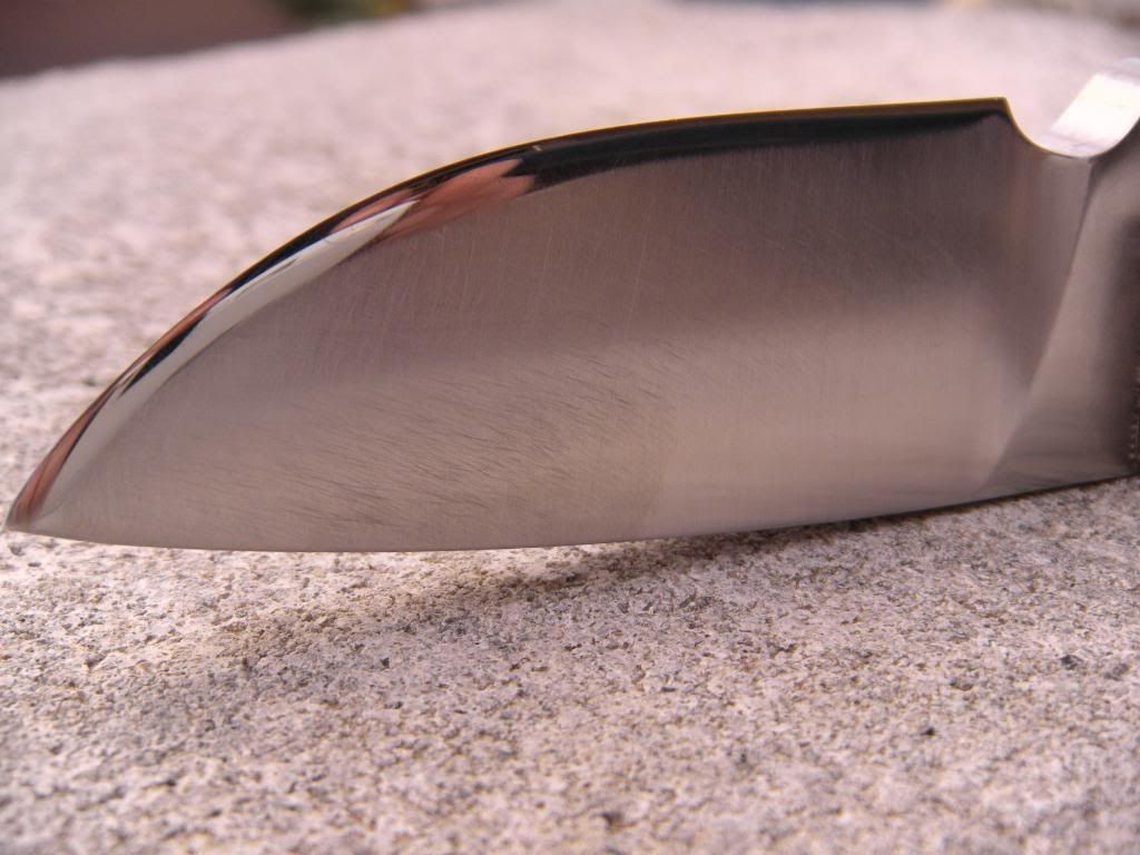

FAT Game Warden
Battle Mistress, first edge reprofile:
Battle Mistress, second reprofile:

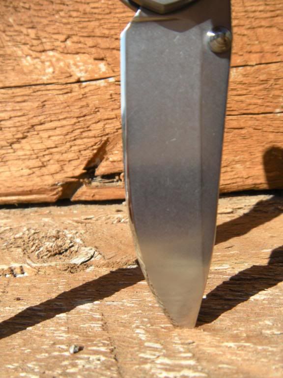

You can do it on thin knives too!!!
Busse BAD:

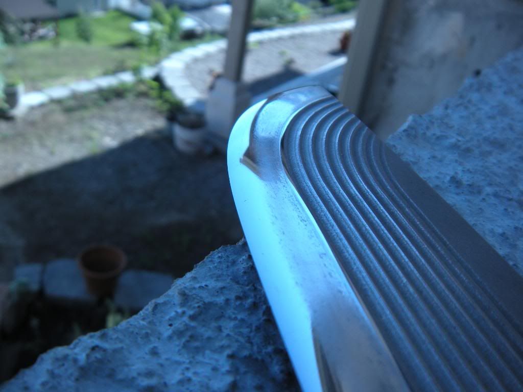

Sebenza:
