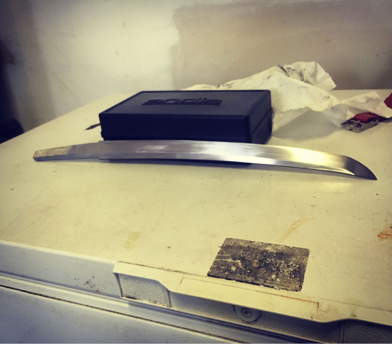

Hey guys I've been trying to get a nice sharp edge on my convex zero grind Japanese style blades for a while and I just can't seem to get them sharp. They are sharp off of the grinder but when I hands and they are always full or only fairly sharp. I keep an eye on where I am sanding and have tried a hard backing and a leather backing. How do you guys get them sharp? Is there a trick to not roll over the edge? I know a lot of bowie makers do a variation of this geometry so I would greatly appreciate any advice! Thanks!

here is a picture of the current blade I am polishing/sharpening. I know it can be done with stones but I don't have the training or patience for that. Thanks guys!
That blade looks really nice. I would definitely be sharpening that on stones (after the surface is finished). I would guess that grinder is too 'coarse' of a tool for final sharpening. But yes, it would be some work.

nice looking blade ! my first guess would be that you are going too far over the edge and rounding it off instead of coming to zero. i think most guys do convex on a belt ? what is your technique.

Right now I'm doing what most people are which is to use a backed piece of sandpaper just as if you were handrubbing the blade and slowly working my why down to the edge so the whole bevel gets polished and hopefully sharper at the same time. That's a good idea with the sandpaper but idk if I could get the curve exactly how I want it
Why does the yokote look so washed out in that picture? And I note there's no hole in the tang yet- was this blade newly forged by a custom smith? I have to believe it would be better to practice on cheaper production blades first, until you get your technique down.
That said, my guess would also have to be that you're rounding the very edge apex a little too much. It's easy to do. Plus, as you progress to finer grits it should start to seem sharper since a coarse edge won't grab arm hair as easily.
The yokote is washed out bc I haven't quite figured how to keep it nice and crisp. I haven't drilled the hole yet. This blade is forged by me
