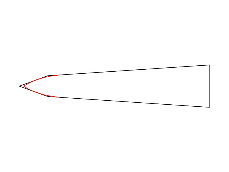

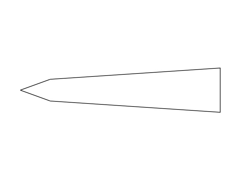

Something to keep in mind is that as you remove the shoulder between the primary grind and the edge, you are almost inevitably going to change the angle of the edge. I think that is something that a lot of people don't realize as they are convexing a knife. For instance, if I start off with a knife with a 20° angle on each side for the edge (40° inclusive) then as I remove that shoulder, unless I am absolutely meticulous in my methods, the point is going to come back some as well, and that angle will increase.
There we have a 20° angle on each side on the edge.
There we have the end result in red of what "convexing" will do, and if you look closely enough you can see that the angle has increase dramatically. This is where the sharpie trick (coating the entirety of your edge with sharpie marker) comes in so handy, because you will need to hold the blade a much steeper angle than you originally did to sharpen it, and the sharpie will show you exactly how much you are missing or whether or not you are even getting to the edge. Use a magnifying glass and make sure you are getting to that edge, other wise you will find yourself in the same boat I have been in numerous times with a knife that just doesn't seem to get very sharp.
