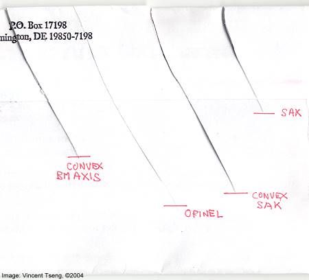

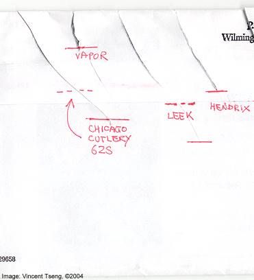

Here's an ad-hoc unscientific test that shows the benefits of convexing either just the edge or the whole grind....
I simply took a typical unopened junk mail (ie: envelope and contents) and took slices with various blades -
From the markings on the envelope the Opinel #8 stainless was the "winner" with the easiest and deepest cut - followed by my convexed edge custom SAK - compare this with a sharp but standard SAK.
Another surprising result was the Benchmade 710 Axis - this came pretty obtuse toward the tip from the factory - it annoyed me enough to re-sharpen/re-profile the edge to my home made convex - now this knife has a noticably much thicker blade, yet the depth of cut was impressive - of course some of this may have been the sheer length of the blade itself........
The most inexplicable was my most used kitchen knife the Chicago Cutlery Walnut 62S 5" utility/boning knife - this is a real cutter for kitchen stuff - but was quite an under-achiever here (and proud of it? :D )

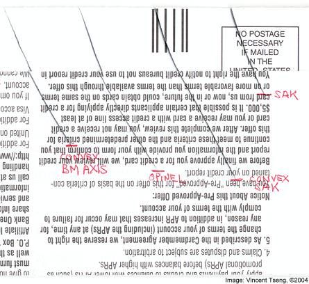

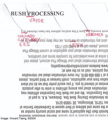

Opening the envelope to count the thickness of paper - revealed another surprise for me....
The contents shows that the Convexed SAK out cut the Opinel! The Opinel's tip must be sharper or pointier and sliced through the envelope at the end of its stroke without cutting through the rest of the contents......
Another interesting point is that there is variable thickness of papers - there is a tri-folded piece of paper shown in front of an enclosed business reply envelope - this discontinuity was enough to stop some blades or cause enough difficulties to retard the cut......
The most disappointing was the Kershaw Vapor - which I know works well as a general purpose cutter, and great value for an integral frame-lock knife - it seemed to be stopped almost before it began to cut..... could be the typical wedge edge bevel and distinct shoulder/corner plus the blade is bead-blast finished that may cause some resistance/binding for cutting through. Nevertheless this is surprisingly disapponting as I know in everyday use this is fine.......
So what does this prove if anything?
Well, strictly speaking nothing much - since this test, though I tried to make things as equal as possible, really only applies to slicing through 11 to 14 layers of paper.
However I am really pleased with how a simple modification to SAK of a convexed edge shows that it can out-perform even the already well-respected standard SAK.
But draw your own conclusions :)
