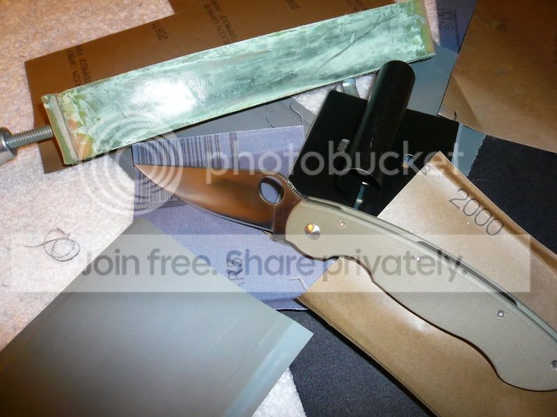

spent a couple hours convexing the edge on my millie.
labor intensive, but worth it i think. i may still work a little on the shoulder, it is more pronounced than i had hoped.
very sharp, and hopefully easy to maintain.

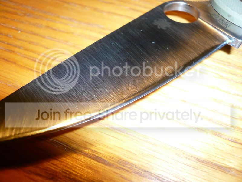

it may be the lighting but it looks like you scrached the hell out of your blade. I did the same thing to mine, but I did mine with a knife grinder in 2min/w a nice strop :p

Yes, easily my sharpest knife now and much easier to maintain as compared to using my sharpmaker. However, I would not recommend this for everyone. If you are not familiar with convexing blades I wouldn't go practicing on your milie. Start with a cheap SAK and get the hang of it first. I found the milie to be exceptionally hard to convex. YMMV.

on a side note, I have found a strip of 3mm neoprine under the sand paper gives me the best results.

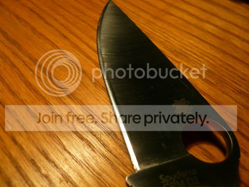

Be careful with the thinned tip on that Military. Mine was so pointy it would slide into the palm of your hand with just the weight of the knife (most knives can rest point down on your hand without penetrating). Unfortunately that tip also breaks off incredibly easily... like, cleaning your fingernails easy. After re-profiling it for the second time I gave up and made it a micro tanto.

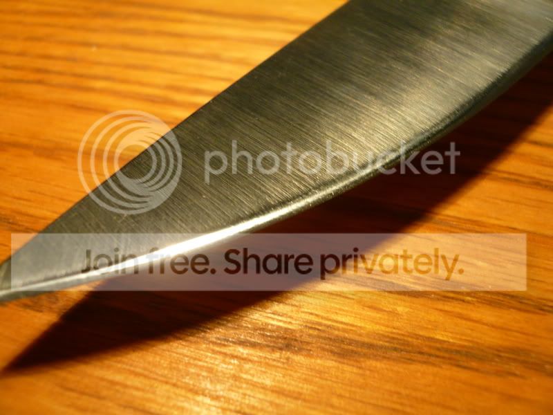

the scratches aren't that noticeable in person. the lighting magnified the scratches, and minimized the convex visual.
but its also been a user, so it was all scratched up anyway.

I just knock the shoulder off and use a strop on it after the edge is convexed.
Done it on almost all my much used Spydies. On the hollow ground ones it is just the edge.
Only the saber ground ones get anything resembling a full convex grind.
