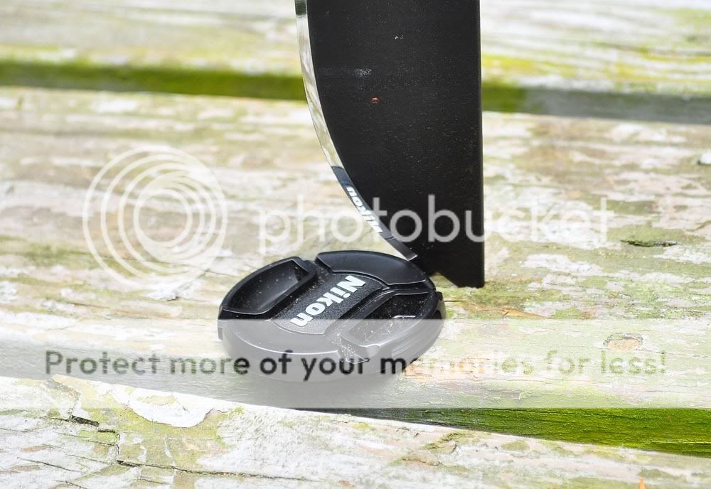

If there's flex to the belt, its convexing. It may not appear it on thinner pocket knives because it's not needing to remove as much material above the edge. A lot of people when they think of convex they think of wide shiney bevels, which is usually the case. Here's an example of a traditional convex zero grind I did on my kalamazoo 1x42.

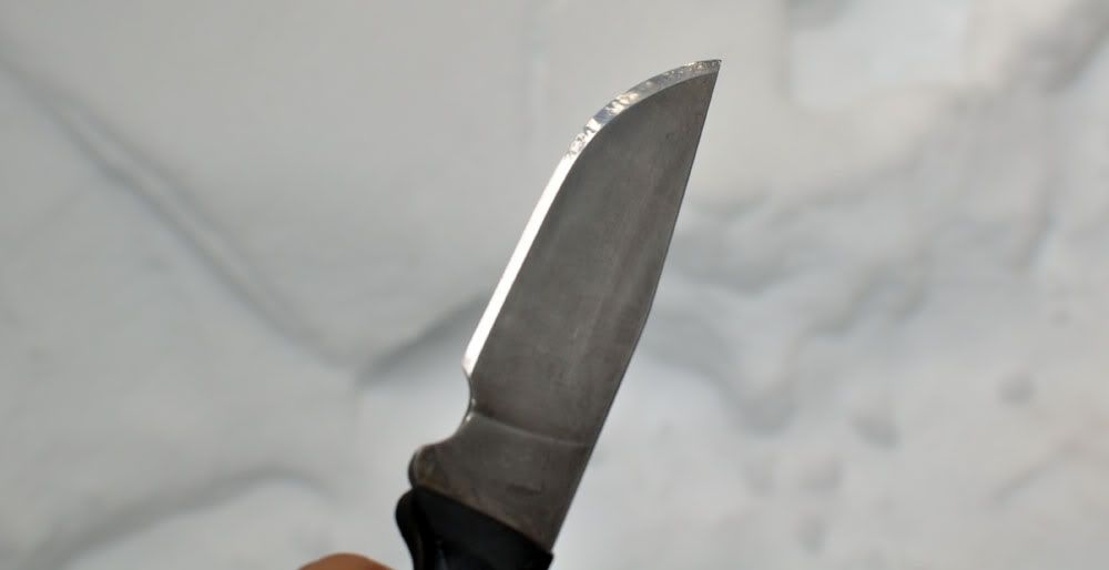

Here's a V edge with a bevel so wide it looks convex. This was done freehand on DMT stones.

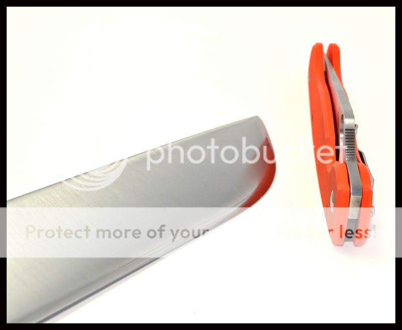

This edge however IS convexed, with a much smaller bevel than the above knife, because less material needed to be removed above the edge. Done on my belt sander.
