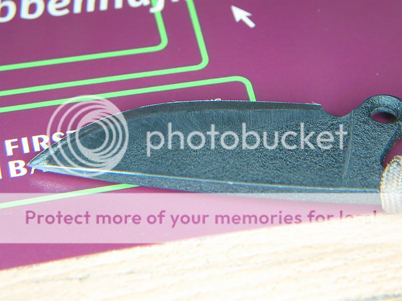

Convexing skills..
I read they arent anything to brag about but they get the job done

I use it for many tasks around the shop and really wonder how I got along without it. The first project was restoring a well loved Sarsquach, with a belt grinder and leather strop you can convex to a wicked sharp edge!
You first need to raise a burr along the entire edge before going to finer grits. I used an extra coarse diamond benchstone to reprofile, sandpaper to refine.
