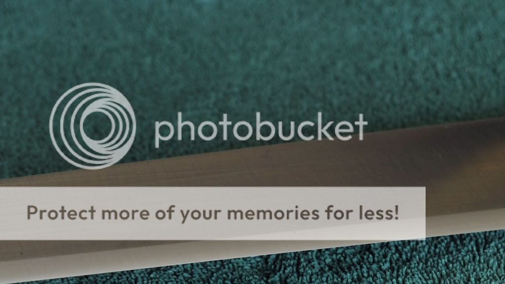

Convexing the High Street
120 is a bit too rough you may wanna start with 300 to 400. u shouldn't need 120 unless you got nicks or damage. nice job for a first go though :)
I tend to just need to touch up. I usually just convex slowly over time using the sandpaper technique with the original grind. Why waste steel if it still cuts fine.
