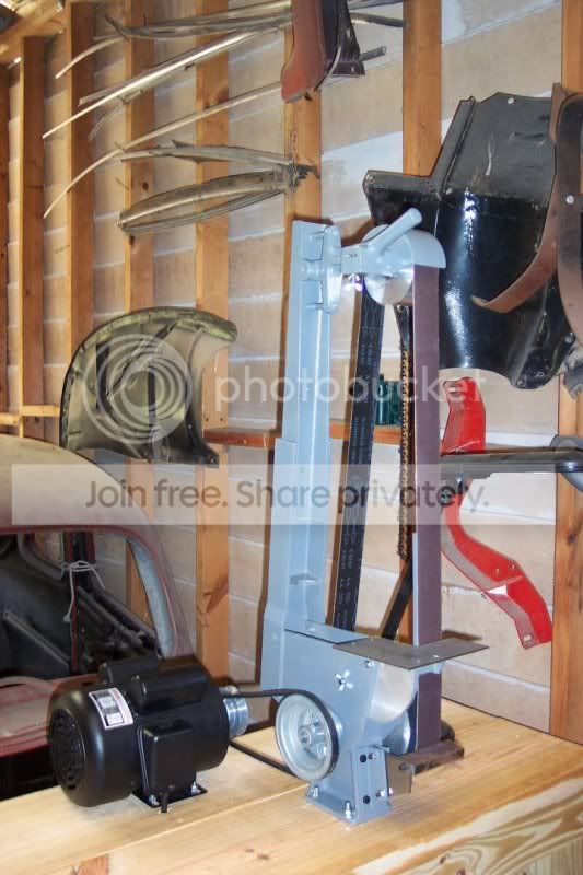

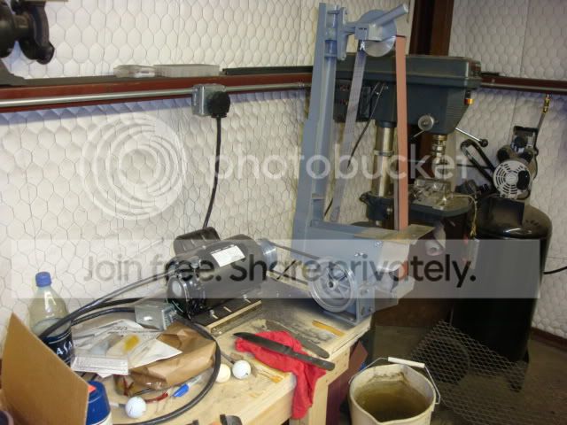

Does anyone have any pictures of their Coote set-ups? I just bought a used Coote grinder and am now faced with what motor to get and how to set it up. Thanks!
...that was before I cut out a hole under/in front of the wheel for the sparks to be thrown down into a bucket. I have a 1 hp TEFC motor on it, and it runs pretty smoothly. I just keep it on the slowest pulley setting.
I run both my grinders off of one dual-output DC motor controlled by a salvaged treadmill unit. The on/off and rheostat are mounted on the bench between the machines and the actual circuit-board is in the gray box mounted on the wall. The Coote is mounted on a sliding bar that locks down with a t-screw. This lets me properly tension the belt and keeps me from hitting the bench with sparks. It also lets me slide the whole grinder out of the way.

Nothing special here... If I was going to do it over, I would bring the grinder nearly to the edge of the table. I need to take the rest at the wheel off... I've never used it. The motor is on a hinged plate so I can change speeds quickly.
Thanks Mark and Mark! Keep 'em coming if you have a pic handy of your set up. Is anyone using a variable speed set up? Variable speed or not, what HP motor should I be looking for and where is the best place to buy?
My coote setup looks almost identical to Mark's 'cept the board my motor is mounted and hinged on is further back using a longer belt, and is kept tensioned with a spring behind it.
Tcurve, here are photos of my Coote setup. I used a variable speed pulley setup. The stand is made from pipe, it has a wrap of aluminum sheet, and a plywood and laminate top. The speed control crank goes up through the top and can change the speed from about 1500sfpm to about 5600sfpm. I also wired up a reversing switch to give more flexibility. I got the disc setup for it as well. In one photo you can see the water trap I added when I built a dust extraction system. One photo is the variable pulley setup.

This is my setup. I have the motor mounted underneath and to change speeds I just lift the motor table and slide the belt to the pulley I want (3 step pulley). I also have the small wheel attachment as shown, and the knife rest. It is an 8" wheel (I have a smooth and a serrated). It is wired for 220 volts. It works well for me, but I am still cutting my teeth as a knifemaker.
